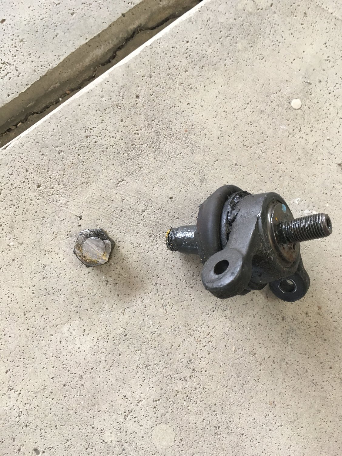

The driver side was a little harder. Had to cut the lower ball joint off of the spindle assembly

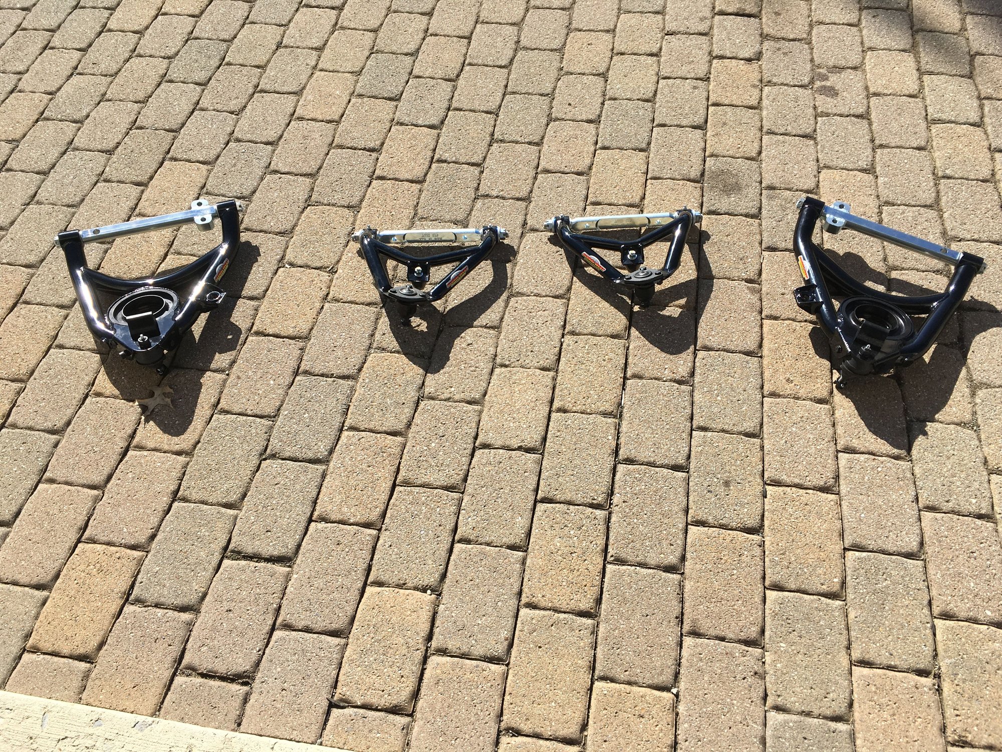

Global West Upper and lower arms ready to go!
