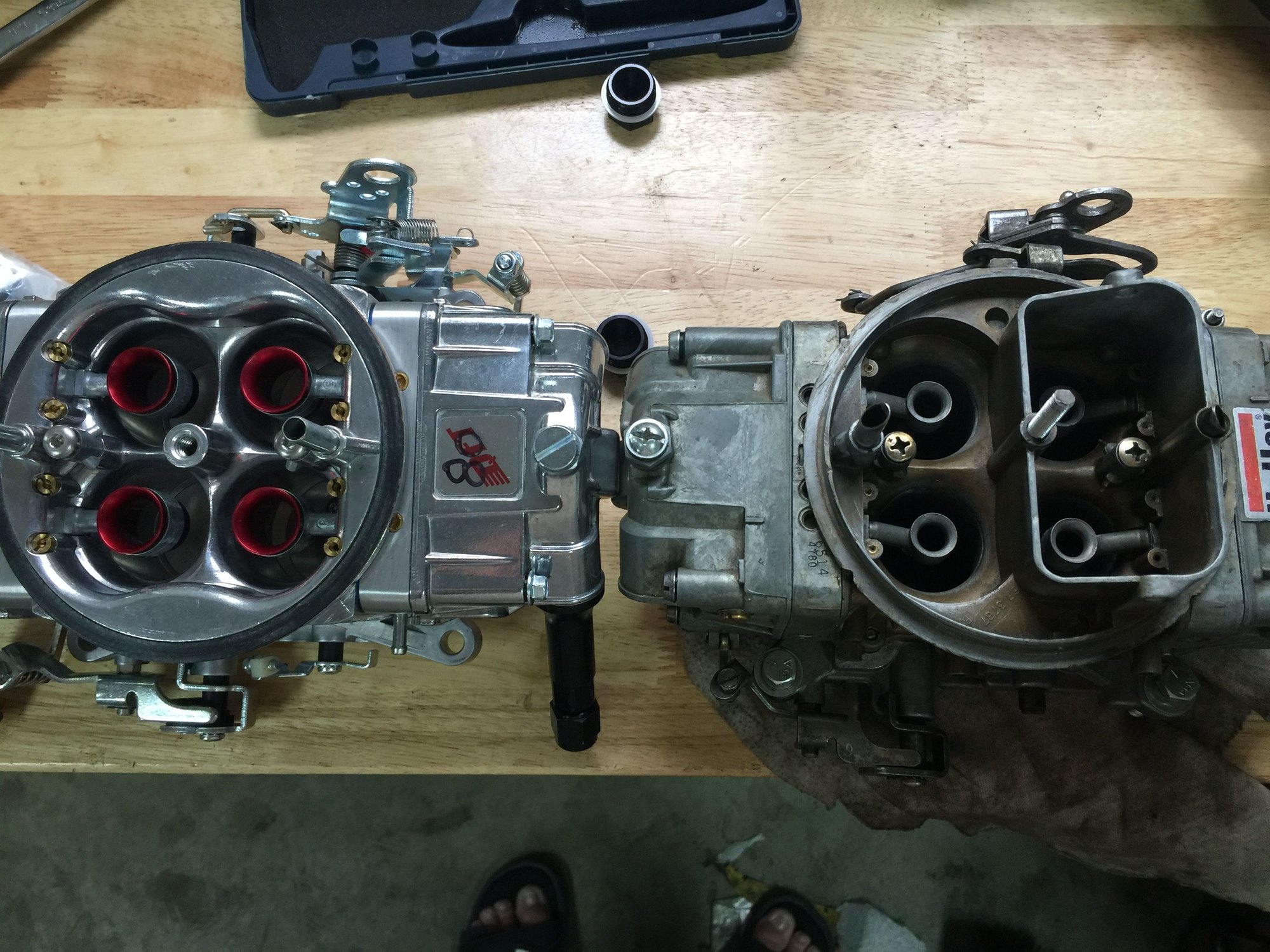

Pictured is my down leg Holley 850 and my QF 1050 Annular. When V2 and Gkull are talking about reduced CFM with an annular CFM rating, you can see why by looking at the boosters.

Just look at the above carb pictures and the QF carb is just beautiful. The air flow to all 4 barrels is even. where a choke tower impedes the secondary smooth air flow
