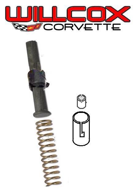

The horn contact has an 'L' on the bottom, is it touching the plunger and the plunger installed in the correct order?
In Willcox Corvette's illustration do you have continuity from 'A' to 'G' at the harmonica connection?

Not sure if I have the spring and pin installed correctly. The parts were missing when i first removed the wheel. If I remember right the pin is kept in contact to the "L" by the spring or at least that seemed logical to me. It could be that I have these parts installed incorrectly. I'll need a few days to get time to check the continuity. Thank you.

This should help you.
Willcox

Thank you for posting shea papers and the Willcox photos huge help as this was all uncharted territory.
I managed to finally get continunity at the last place. At the bottom of the turn signal switch where the ground wire was burned off........ Ground wire on bottom of horn contact on turn signal switch burned off.....
