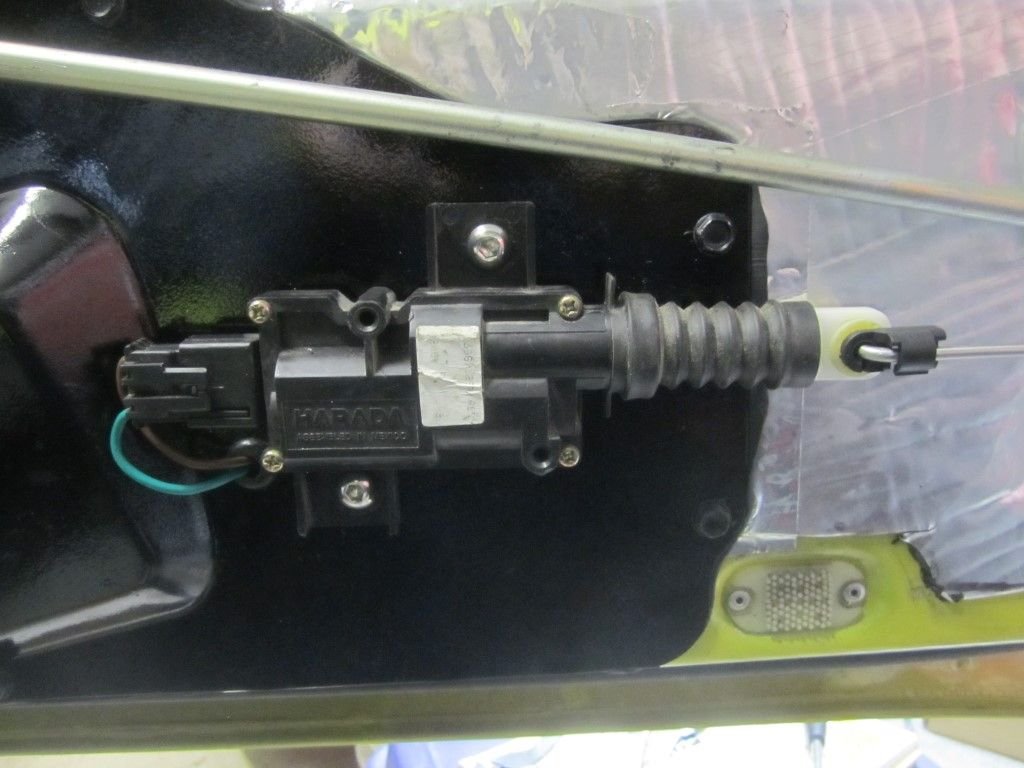

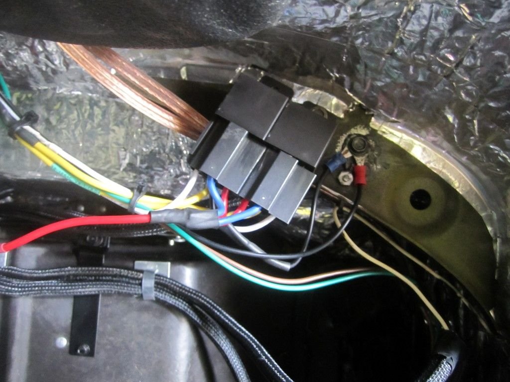

If you've got power windows it's pretty easy as there's already a tube for the wires to go through, otherwise you'll have to really think about removing the door to get a tube in or use the thin ones for the street rods

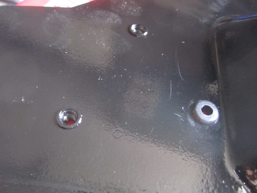

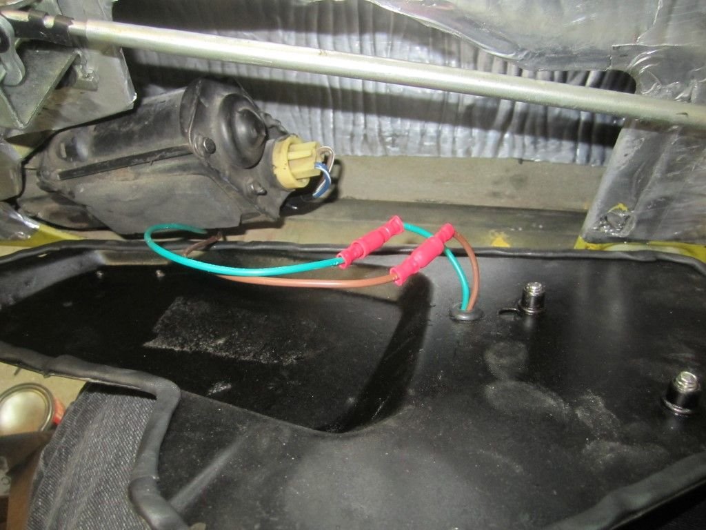

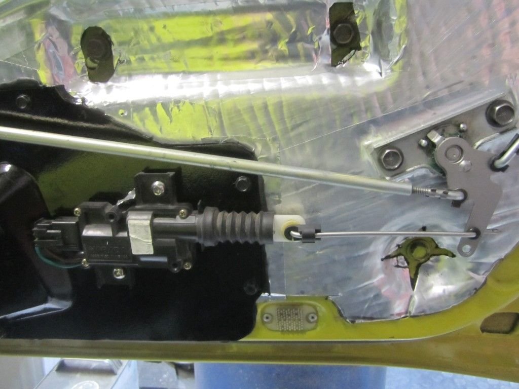

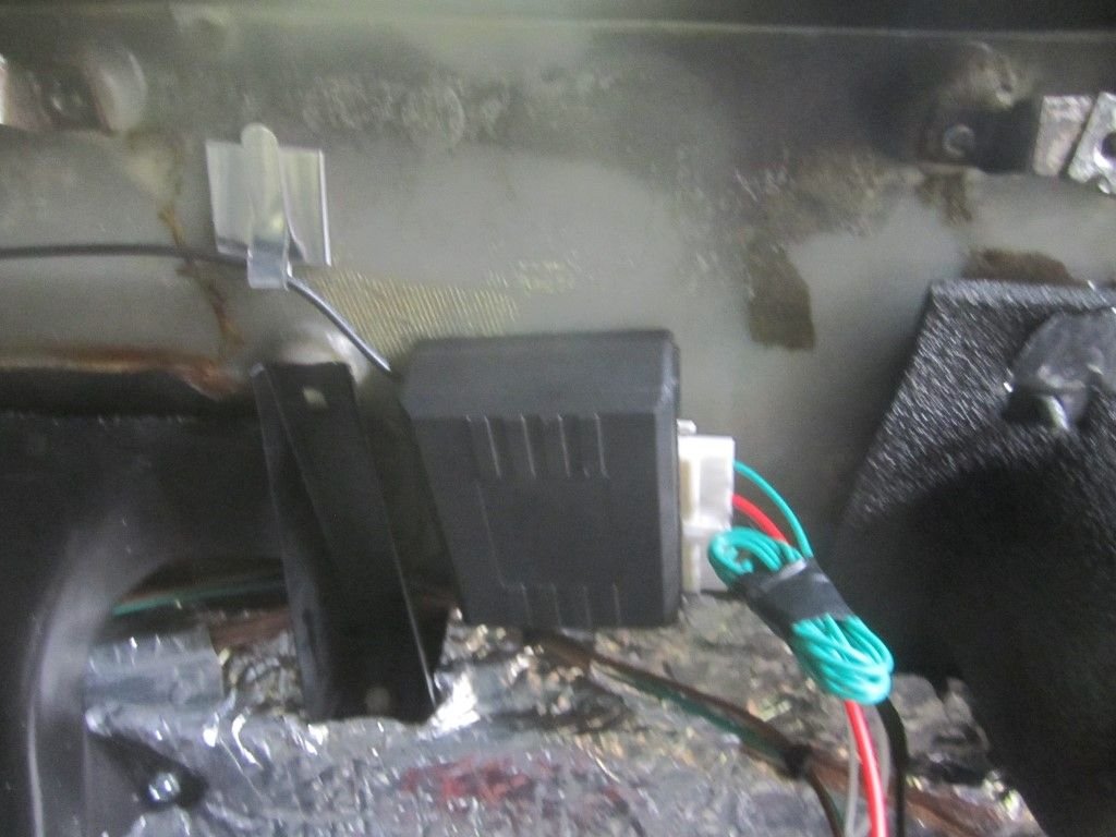

I never did a write up but here's the basics on mine
Remote receiver mounted under the dash pad, relays (although not really required on the newer actuators I still like using them) are mounted to the dash brace
I got some actuators off a newer import from the wreckers, they all use pretty much the same mechanism
Installed nut-serts and a grommet on the inspection cover
bullet connectors (replaced with weatherpack next time I have the door off
Mounted
On the pivot linkage I machined a piece to fit over the original but people have used larger fender washers to the same end
Linage hooked
I had to add the second hole in the arm as the actuator travel was slightly shorter than I originally checked (it moves farther but has not power at the very ends)
M

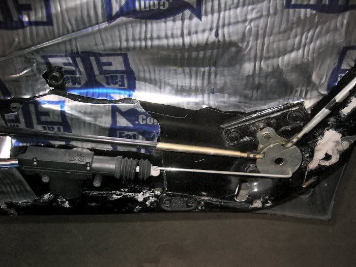

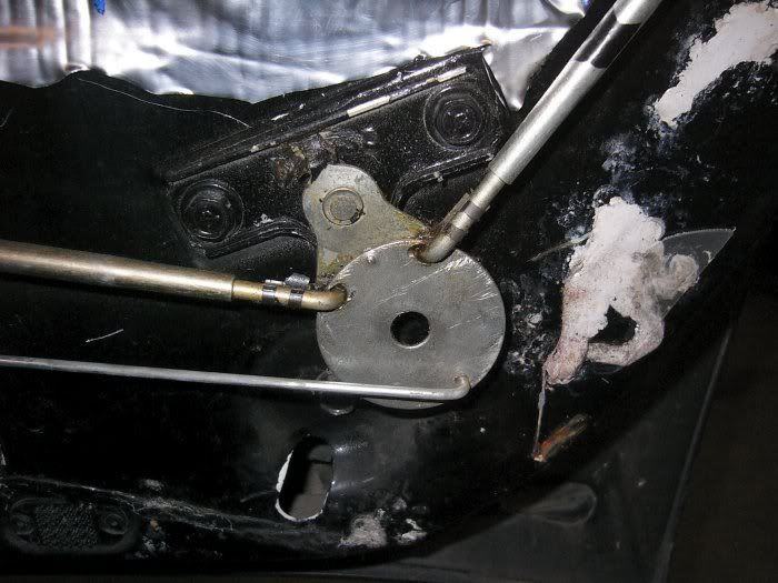

Here's someone else's fender washers for the bell crank
Sorry I can't give credit where it's due as I don't recall who or where I found those imaged, just ended up in my collection. If I had to guess it'd be 7T2 or DB

Here, Cortana found Durango_Boy's original post for us: https://www.corvetteforum.com/forums...post1566484410
