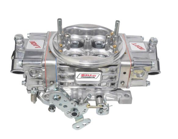

I've decided to run an 850 cfm Quick Fuel Carburetor on my 496 build.
Holley Tech Services recommended their Quick Fuel Street SQ-850, which has cast aluminum fuel blocks and a cast aluminum base plate, for $548.95.
They also offer the Quick Fuel Q-850, which has billet aluminum fuel blocks and a billet aluminum base plate for $772.00.
Both carburetors have no choke, mechanical secondaries, vacuum ports and the same internals.
Holley Tech Services said the billet carburetor is better quality, but doesn't offer any performance gains and said that the Quick Fuel Street SQ-850 is still better quality than their Holley HP series carburetors.
For those who run the Quick Fuel carburetors, is it worth spending the additional cost for the billet fuel blocks and base plates?

without going into the long story. Lots of cast carb venturi bodies are not 100% equal in dimensions. Some of them are so poor in even positioning the boosters that you can see that they are off whack compared to the center of the bore
so you end up having to spend hundreds of dollars in machine work to correct all the poor workmanship. So all these after market companies make sure that it is right out of the box. Bigger bowls with sight glasses, better floats, quality large diameter needle and seats, correct diameter idle circuits, drilled throttle blades
the list goes on of everything you have to fix on on Holley and the crap model year Demon carbs .

They are both excellent products. You can not go wrong with either.
They both have the exact same calibration, so it really comes down to if you want to spend the extra $200 for the billet metering blocks and base plate.

The billet blocks are probably more adjustable. The website says they offer changeable idle feed and power valve channel restrictions. That would offer more tuneability of the carb. The cast block would just have sized holes drilled in them and offer no tuneablity.
Let me also add the billet baseplate does not have the notches for a factory style throttle cable bracket.

When I called QF when they were QF he asked about the cam specs.
After going over the rest of the build he recommended the Super Street Series because of the metering blocks.
Holley's web page don't have an much detail about the differences that QF had on their web page.
One thing I HIGHLY recommend is getting the Holley Adjusting Lever Kit
Amazon Amazon
I was having a hell of a time getting enough air for a good idle because I had to open the primary's too far. Made for a crappy off idle drive. I reset the slot to spec and used the rear opening to get the idle I wanted. Now it comes off idle easy.

My vote is for the billet build Q 850 . I have been running mine on my little 355 cu in for the last two years now . Will not say it runs better than my old Holley but is nicer to fine tune . Also has the secondary adjustment on all ready no need to buy .
