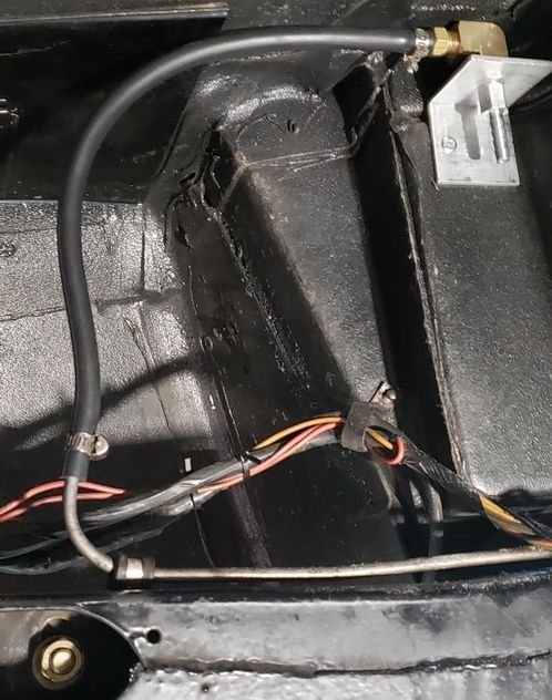

Interesting that you mention doing this. I had the same realization and just finished up mounting the rollover valve this past week.
