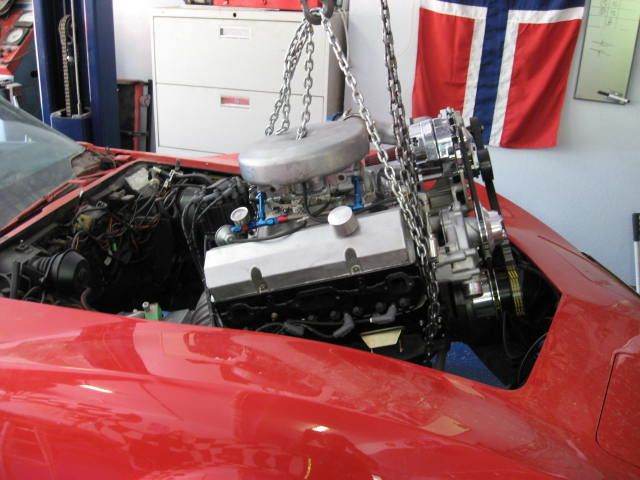

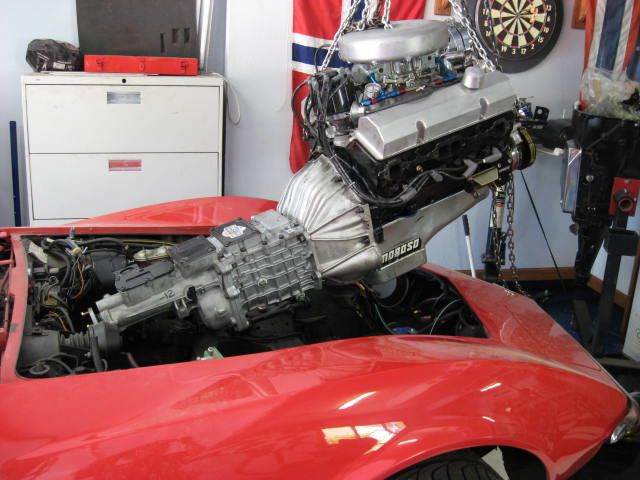

As Mooser stated, it's a PITA to install the tranny after the engine is installed... You will save yourself a ton of cursing and Band-Aids if you wait until you have the tranny. Bolt the tranny to the engine. Drop the entire assembly in and make your life easy.
This is a non-removable crossmember car:
