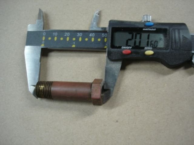

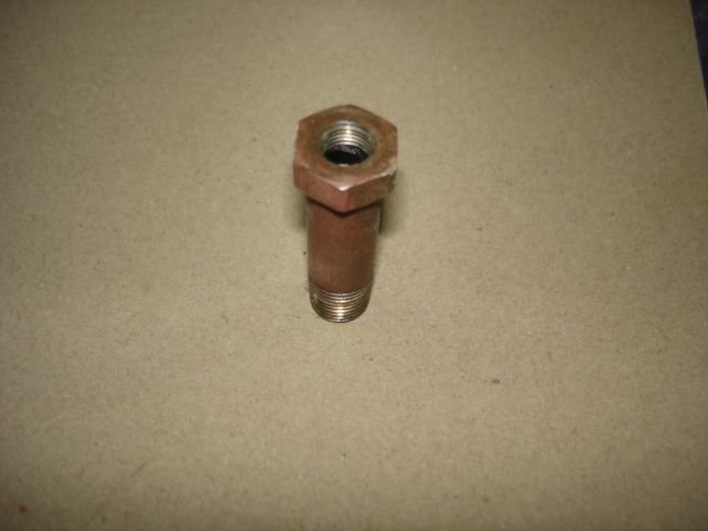

The oil pressure sender hole above the oil filer requires a special long brass fitting that can thread into the hole in the block due to being larger threads than the sender has. Then this fitting is reduced down to the threads so the sender can be threaded into it.

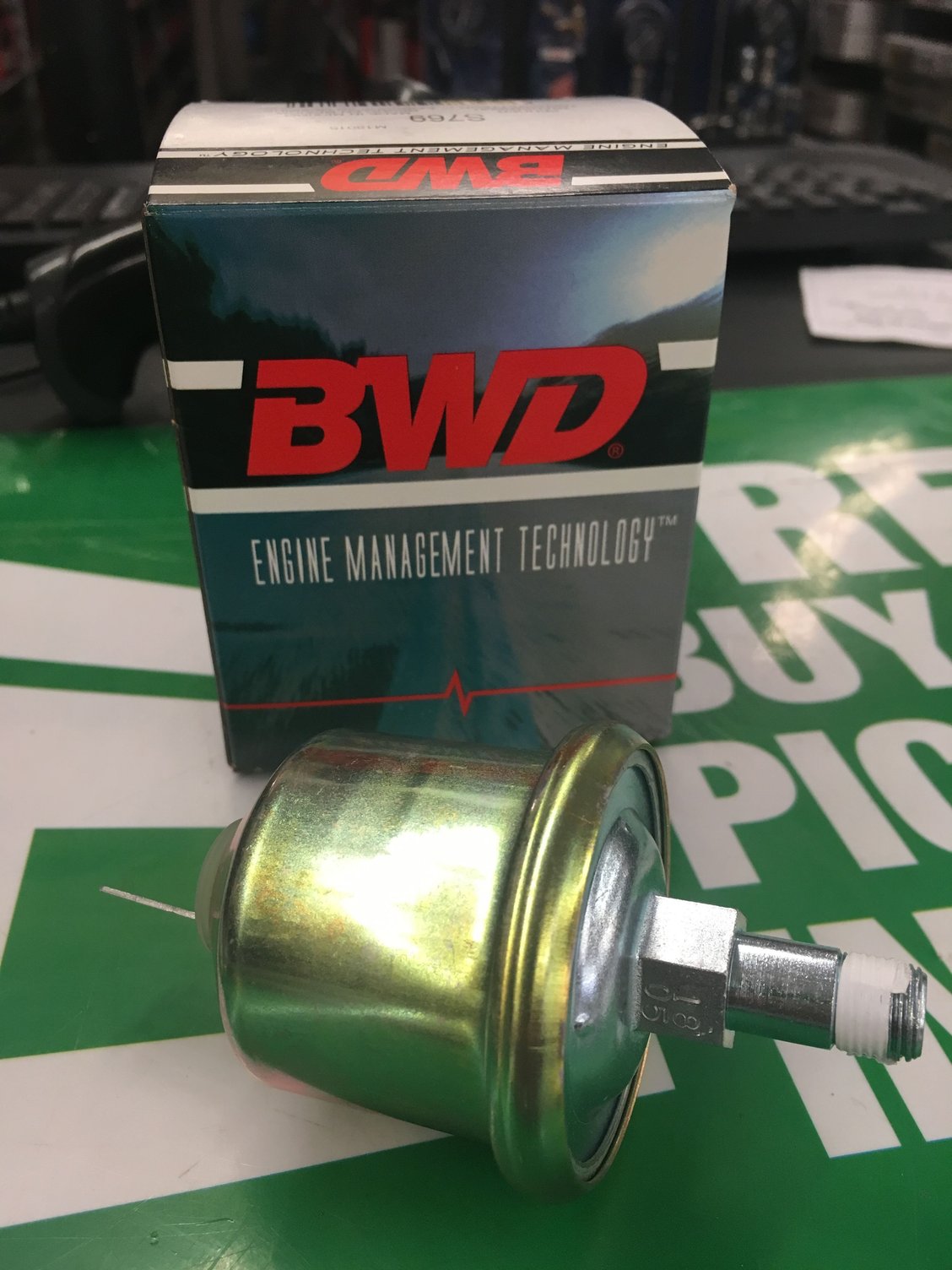

I bought the correct oe style sender at O’Reillys today. Both-Warner S769. $30 bux.

Originally Posted by av81
What about the brass 90?
Mine has a straight (not a 90) brass tube that connects to the block right above the oil filter. The ZZ6 block is exactly the same so I’m hooking it up just as it was. Got a new sender for the heck of it.

On the oil port above the oil filter area. A brass 90 degree fitting will not work due to the recess in the casting of the block that would make this a BEAR. Using the correct straight fitting or making one up is best due to it brings that area outwards an allows the oil pressure sender to be easily attached.

Originally Posted by carriljc
DUB, is this what you're describing? Just curious (since I have a 68). Anything special about this? Looks like something you could get at a hardware store?
replacement:
https://willcoxcorvette.com/corvette...to-block-74-79
reconditioned:
https://www.paragoncorvette.com/p-35...r-fitting.aspx
YES.
Here are photos of an original I have below.
I know that other fittings can be used that may be able to be shorter...so the choice is up to the person doing the job.
