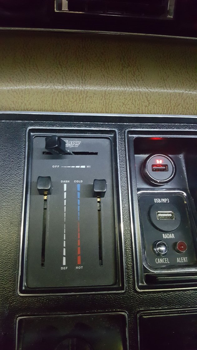

Also, in my 74 anyway, Classic has what they call a D.E.R. controller that totally takes the place of the clunky factory control levers instead of placing electronic "lady fingers" over the existing, clunky cable controls.
