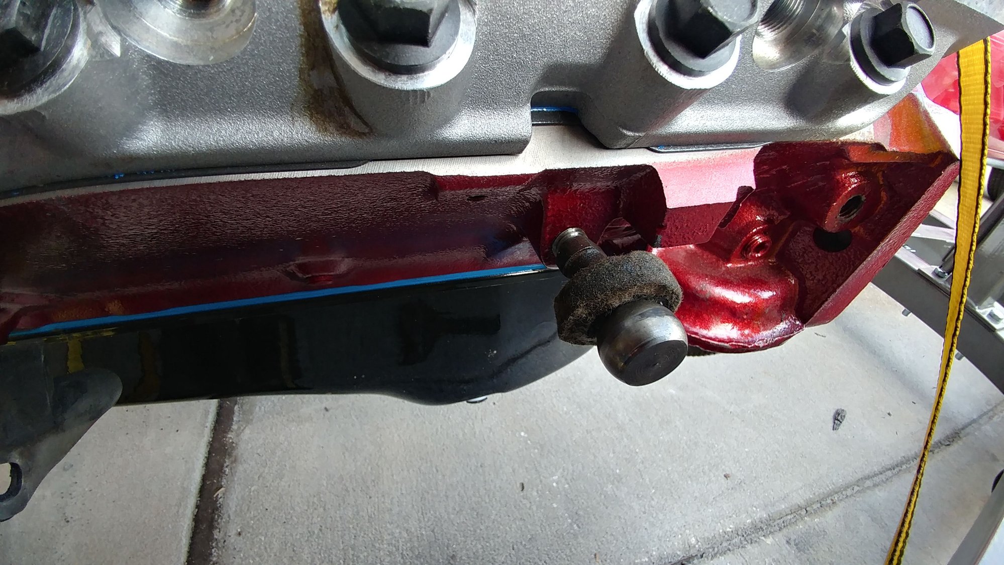

Aztroth's Avatar
Aztroth
Joined: May 2016
Posts: 36
Ok, well, this is the solution I've come to. Mostly because it was free, since I already had the drill and tap. I had to do it with a basic power drill, but its in. I'm gonna try to get it in another thread or 2, but its not a big deal if I can't. Its pretty solid right now.

Don't get too greedy going for the last threads, busting a bound up tap in a hole is a PITA. If you have a bottoming tap, you can get your last few threads easily and reduce the risks.

I agree..a bottoming tap is almost a MUST...due to not knowing actually how far you can drill into this block before all hell breaks loose.

Ok, well I managed to tap an additional thread without needing to drill deeper, and the engine is back the car, clutch is all connected up and working good. Bell housing and motor mounts are all bolted up, and I'm gonna call it a day. Maybe I'll have it up and running here in a week or so! (Probably wishful thinking)

Hopefully you got it threaded far enough to make sure your pivot stud can bottom out against the block and fully seated.
Keep an eye on this...due to this pivot stud can back themselves out of the block...unless you use some removable threadlocker.
