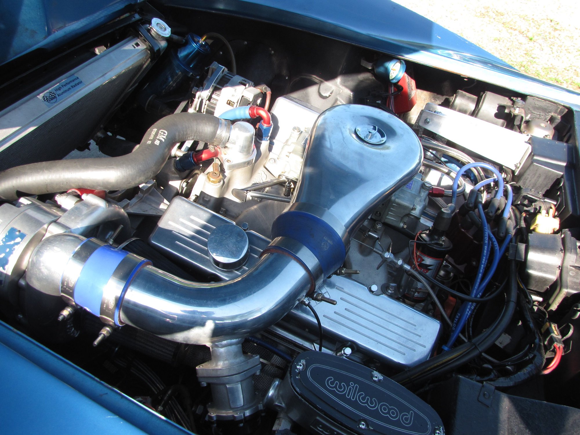

Both front and rear of scoop are open, plus the venting for radiator heat.
Vortec at 9psi boost. Also wrapped the headers with that 'DEI' wrap. T

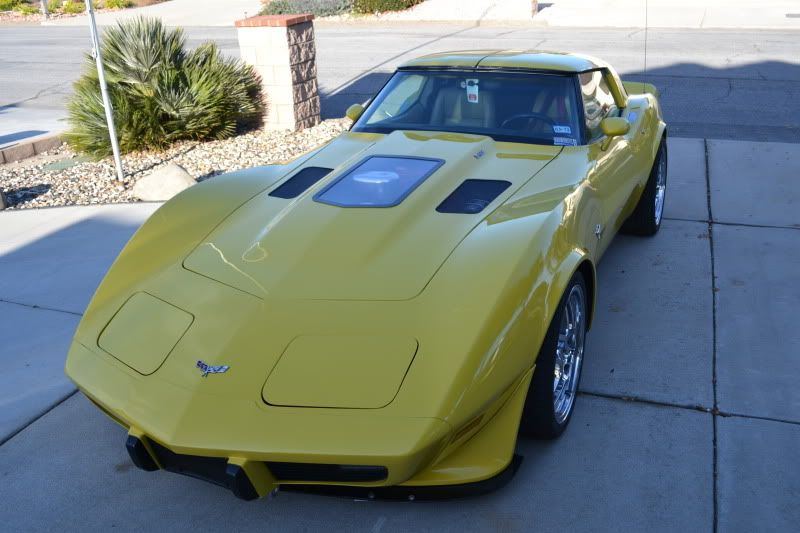

There's a user on here called Bee Jay that vented his hood a few years ago.
Here's a link to the final product.
Edit:
The Photobucket issue will prevent the photos from displaying unless you're on Chrome browser and using an add-on extension.
Here's a photo.

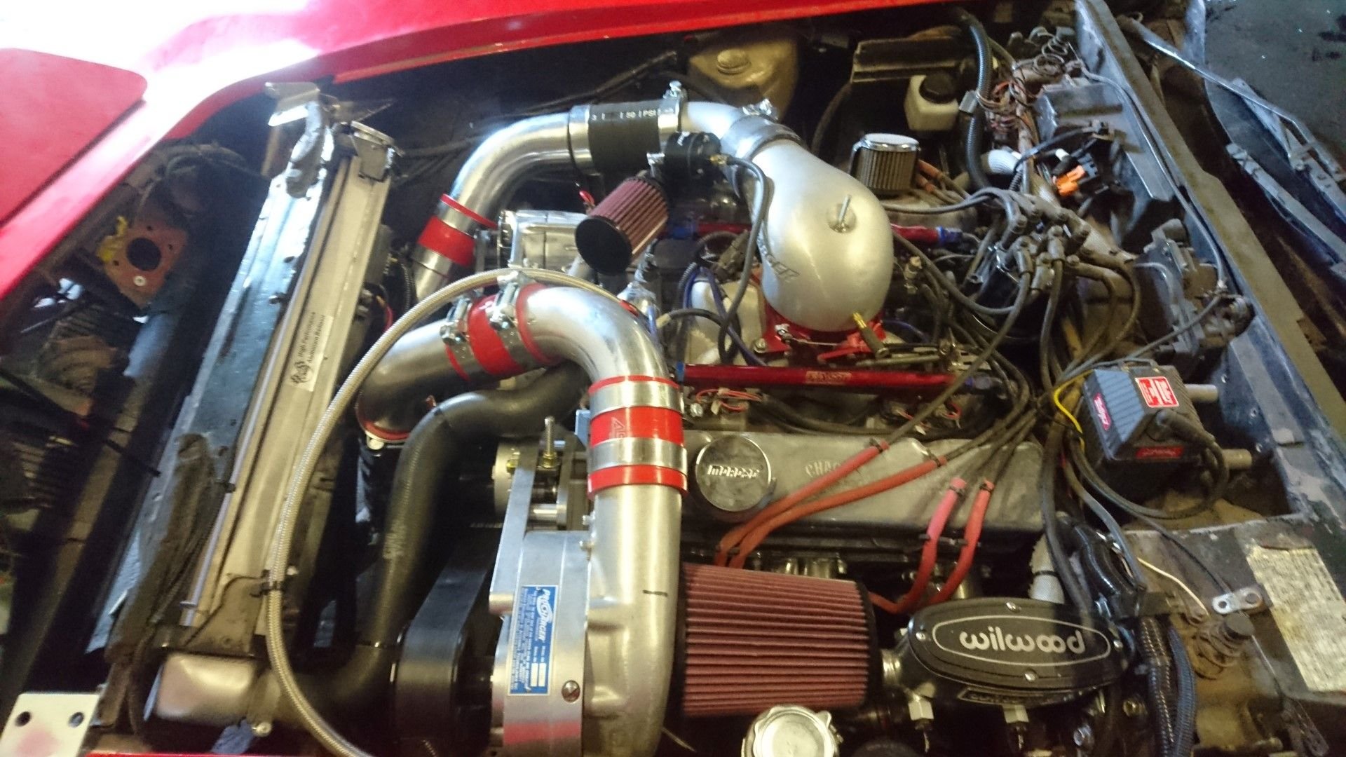

pics below of my setup, running procharger at 16 psi, plus a intercooler out front, which i think is where a alot heat is coming from and then it ends up heat soaking the radiator, still need to do a new aero scoop under intercooler

Dave have you checked what the air intake temperature is? Mine was 160* on a 80* day last summer. There was a drastic under hood temp change after the headers got wrapped. Yours looks pretty cool with the fuel injection. Thanks for the picts. T

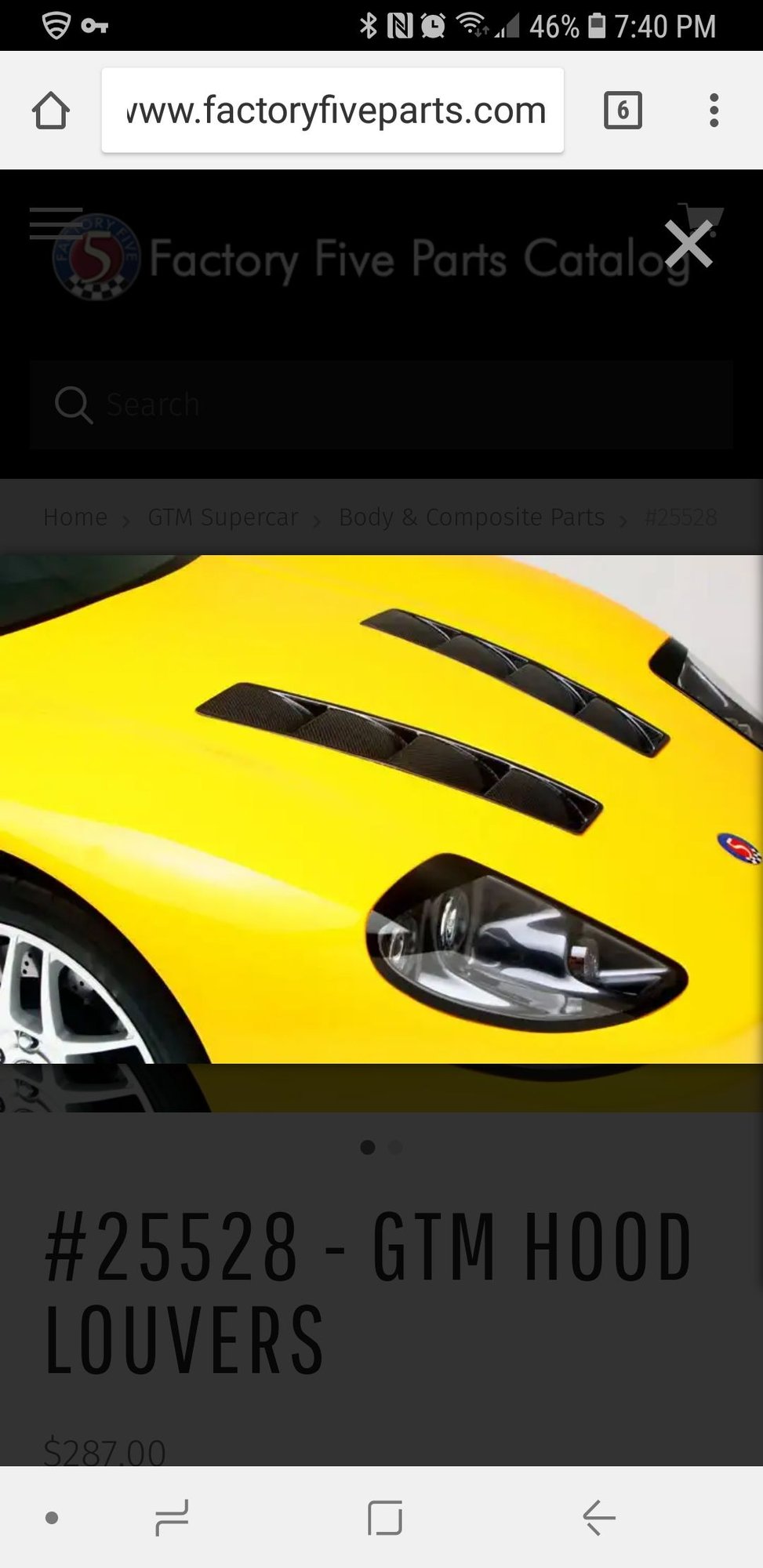

If I were working on this problem, I would consider some good louvers like those used on the Factory Five GTM.
they look nice and nice and big

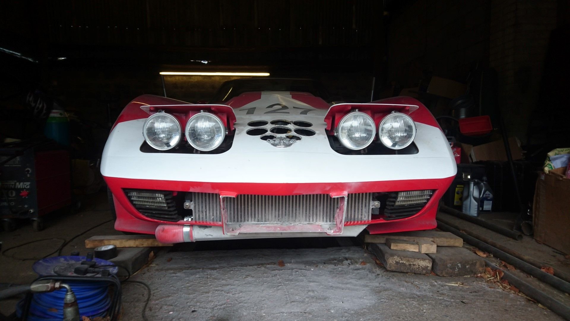

interms of air dams at front what is the best design? like this one below or is better having, but an extra flat edge coming from it??

Hole in hood right above procharger. Is that for clearance? Could you axtend it rearward and put the intaje air up to that hole? Cuz right now you are sucking air right off that left header.
