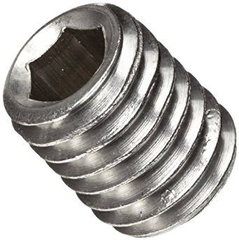

I use stainless steel Allen head set screws like the one in the photo below. The ones I have already have the sealant applied to it. So ..it is up to you if you want to add some sealant or not. The ones I use are short ...about 3/8" long. So when I install it...the end of the set screw is flush with the casting and it is not poking out.

YES..I checked the stainless ones I have and they are 3/8" overall length.

NO..they are more like 1/2"-20.
I KNOW they work.
I measures the outside diameter of my Allen set screws and it is roughly 0.4955".
Measure the outside of the flare nuts and it will be right there at it.
DUB

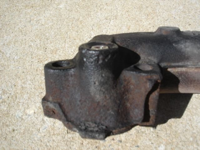

A picture is worth a thousand words. So here is what I have to clear up any doubts ...if any.
DUB
