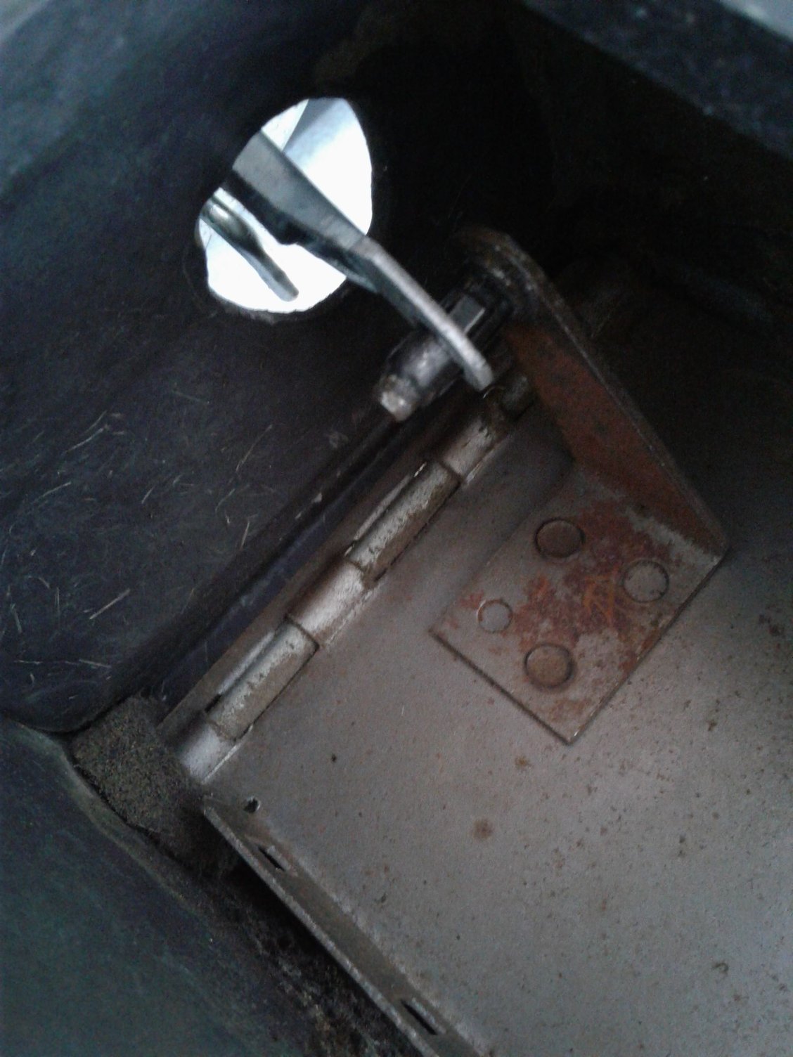

Hi MAC,
"How is the actuator stem attached to the flapper inside?"
I don't know.
Perhaps a flat circular clip like the one used on the pin on this lever?
A very tough one to access!!
Good Luck.
Regards,
Alan
