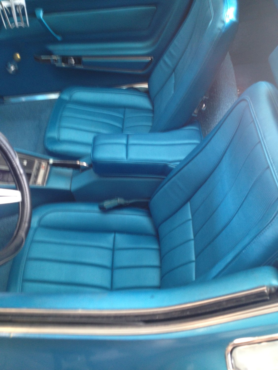

I have been on a long road to weight reduction myself and as much as I would love to drop the 30lbs of steal I just can't bring myself to replace the factory 69 seats. As a convertible with separate headrest seats they are the centerpiece of the interior. Reupholstered them myself and they are indeed heavy.
If I had a coupe would change them out in a heartbeat

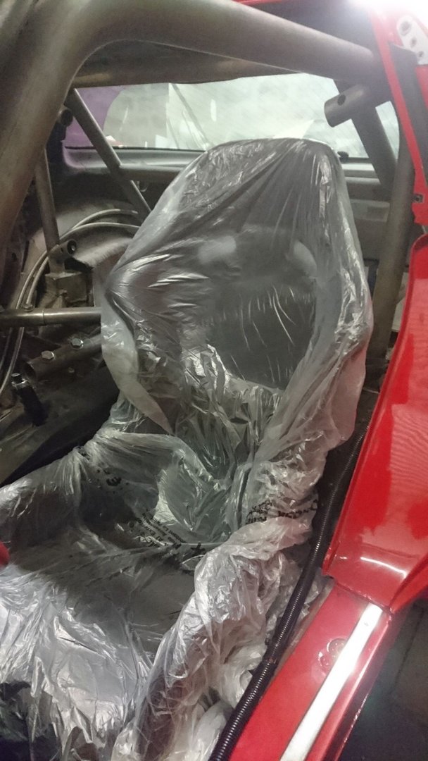

this seat is very light, its a kelvar/carbon hybrid racing seat, lift it with one little finger

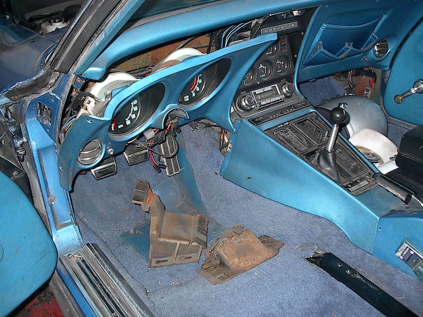

Once you get that assembly out of the car and it's in your hands you'll be standing there shaking your head wondering what the heck was Duntov and crew thinking at the time, installing something like this in a Corvette.
I can only think that this must have been an incredibly cheap component taken from an early 60s impala or something.
What did you replace it with?

Brian76, I replaced my cast iron bracket with the later ('75 and later models, according to MCMLXIX) stamped steel bracket. If you have a '76 you are spared the fun of this exercise.
