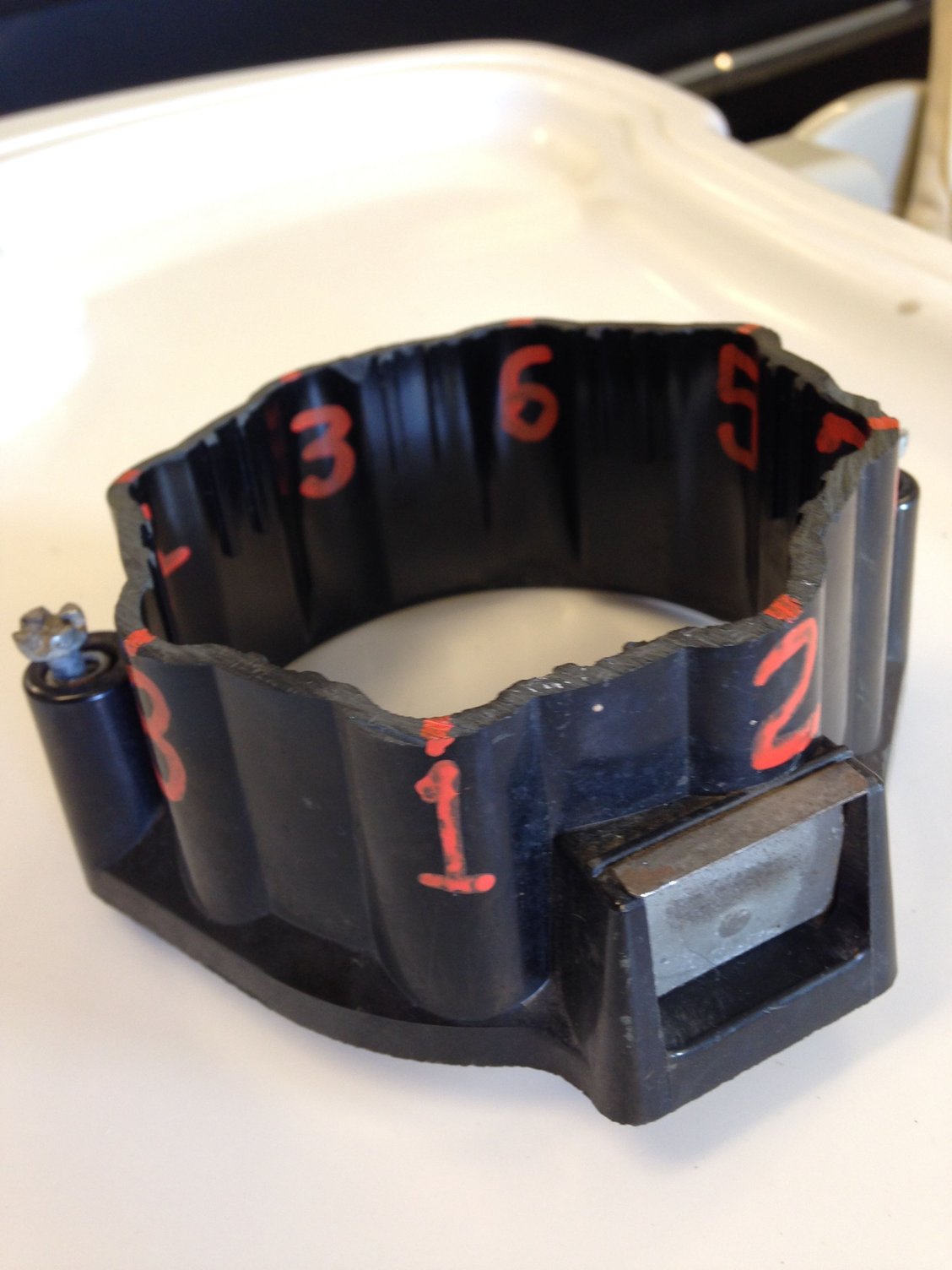

itsforfun's Avatar
itsforfun
Joined: Nov 2003
Posts: 430
Likes: 60
From: Central KY
Default Handy Helper
Attached is a handy tool you can make which can help when dealing with timing and/or valve adjustment. Use a hacksaw to remove the tower portions of a old distributor cap. Then label each tower clockwise according to the firing order sequence, in this case, 18436572. You might want to consider which tower you want for #1. You can see where mine is. Now install the tool on the distributor. With the rotor in place, it is easy to position the engine at any cylinders firing point. If the distributor has been removed and repositioning is unknown, simply turn the engine until the timing marks are aligned. If either valve on #1 is depressed #6 is at TDC, so rotate the crankshaft 360 degrees and both #1 valves should be closed- #1 at TDC. Now drop the distributor in and place the #1 tower in the correct position relative to vacuum can placement and aligning the rotor to the #1 position on the handy tool. The only problem might be the alignment of the distributor with the oil pump slot. A long flat blade screwdriver can be used to move the oil pump shaft until alignment is made.
Hope this helps!
