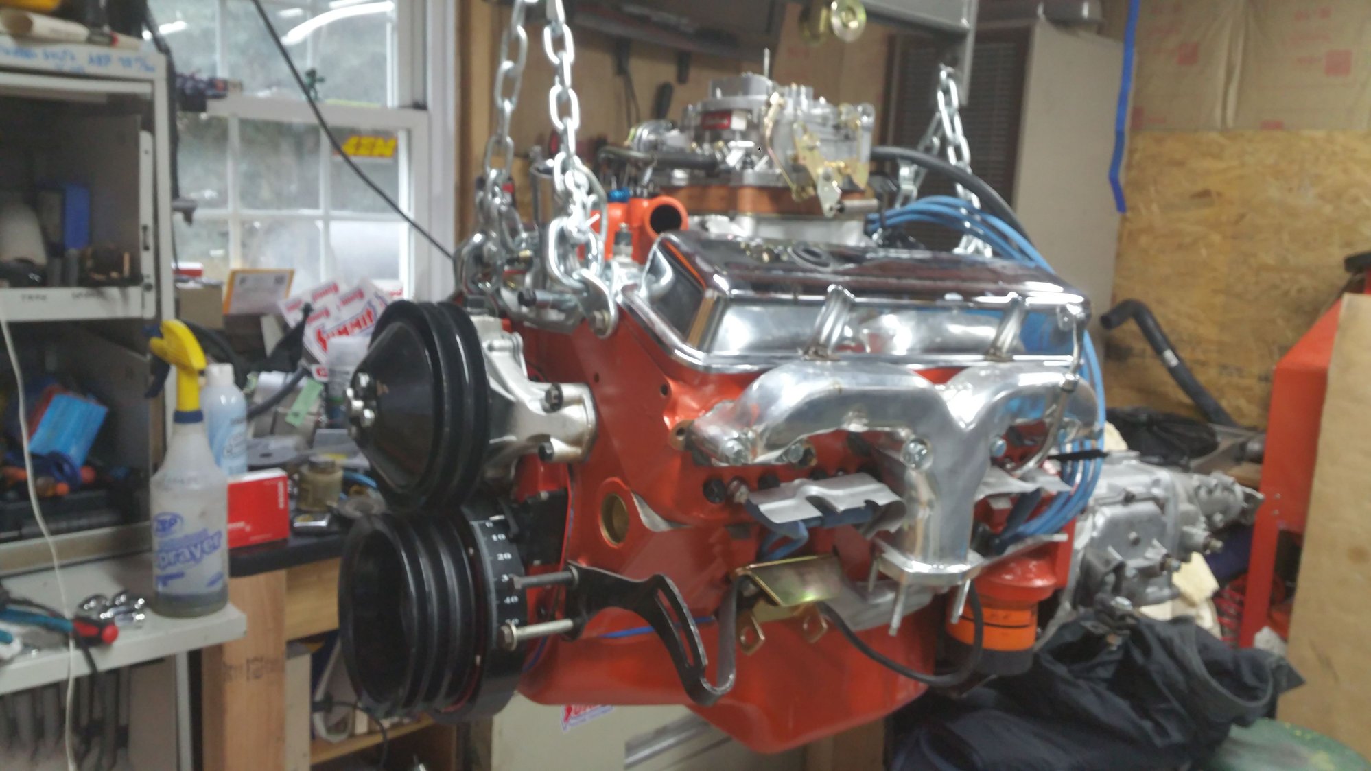

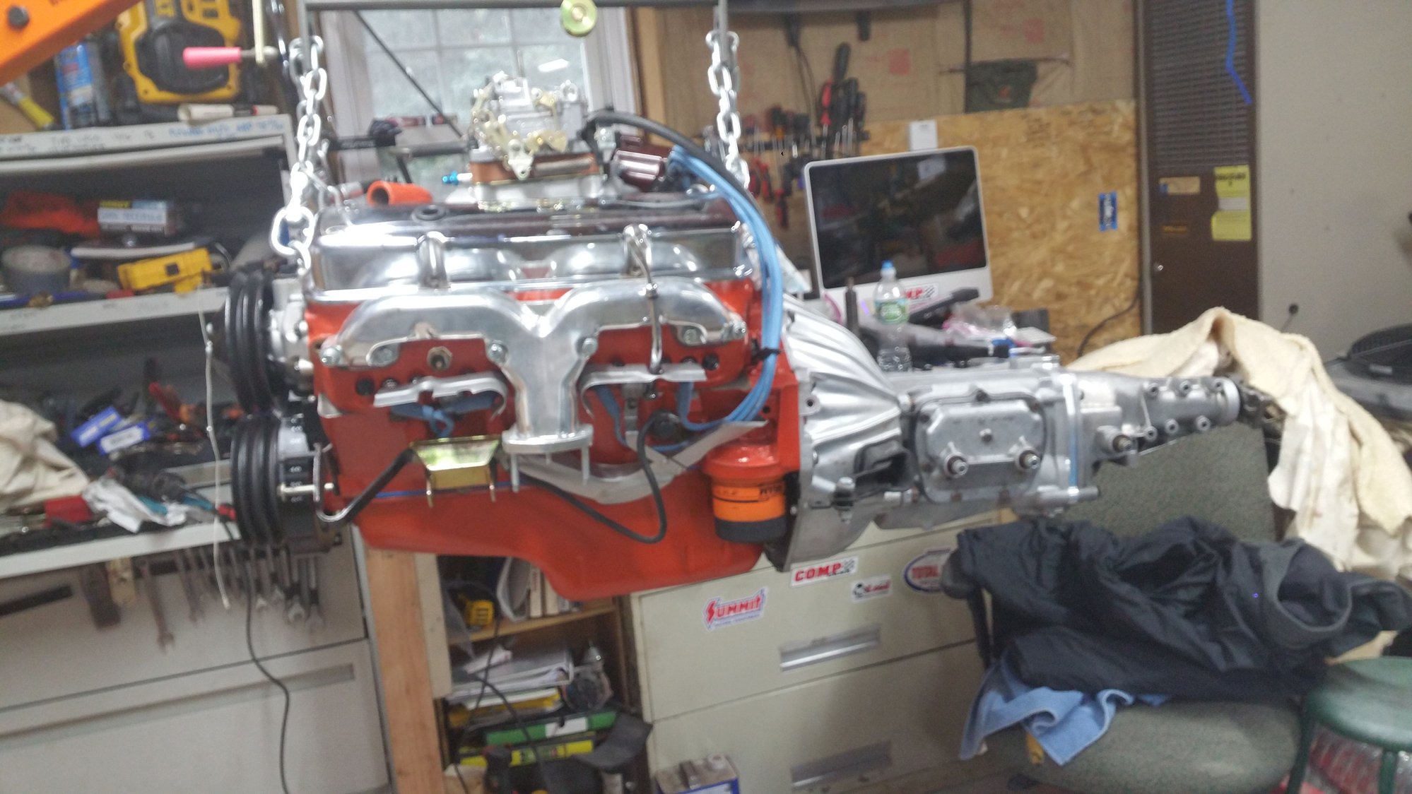

Installed a set of SS headers a few months back along with Pypes exhaust system...Headers radiating too much heat ! Wrapped em with Titanium wrap seemed to be even hotter then with no wrap..They also hang kinda low scrapping on driveways and speed bumps. Sounds great but no thanks done with em! Gonna install a set of ceramic coated 2.5 ram horns.
Post back with the difference in performance and heat issues when completed.. Also if you have 2.5 ram horns the Pypes downpipes DCC10S wont fit, the flange is for 2.25 ram horns..however the pipe itself is 2.5 with a welded 2.25 section for the flange..Pypes need to clarify this...My shipping costs to Hawaii negates returning em ..Just gonna modify em to work..Geez !

Sniper EFI ,its not running lean according to the LCD touchscreen..I'm on the Big island ,Kona side some traffic at times but nice open roads to test things when the foot gets heavy...On the way home I have a 4 mile windy road to check the handling of my new coilover suspension sweeet! Just have to watch out for the Turkeys crossing the road.Yup wild turkeys in Hawaii..Headers gotta go, just heating things up to much..Alternator, hoses,and wiring are just getting toasted in my opinion...Don't remember things getting so heated up with the stock manifolds..Hopefully the coated ram horns cool things down a bit..Alohas!

I've run ceramic coated headers in multiple cars and motorcycles. All of mine have been Jet Hot Sterling Ceramic coated inside and out.
They make a huge difference on underhood temperatures and on a motorcycle it's less heat on your legs or feet. Stainless alway seems to be the hottest, probably because it's usually thinner walled than mild steel.

You'll loose some top end horsepower but I dont think much bottom end torque. I have 2.5 inch summit rams horns to 2.5inch sweet thunder pipes. I really like them and they never loosen up
