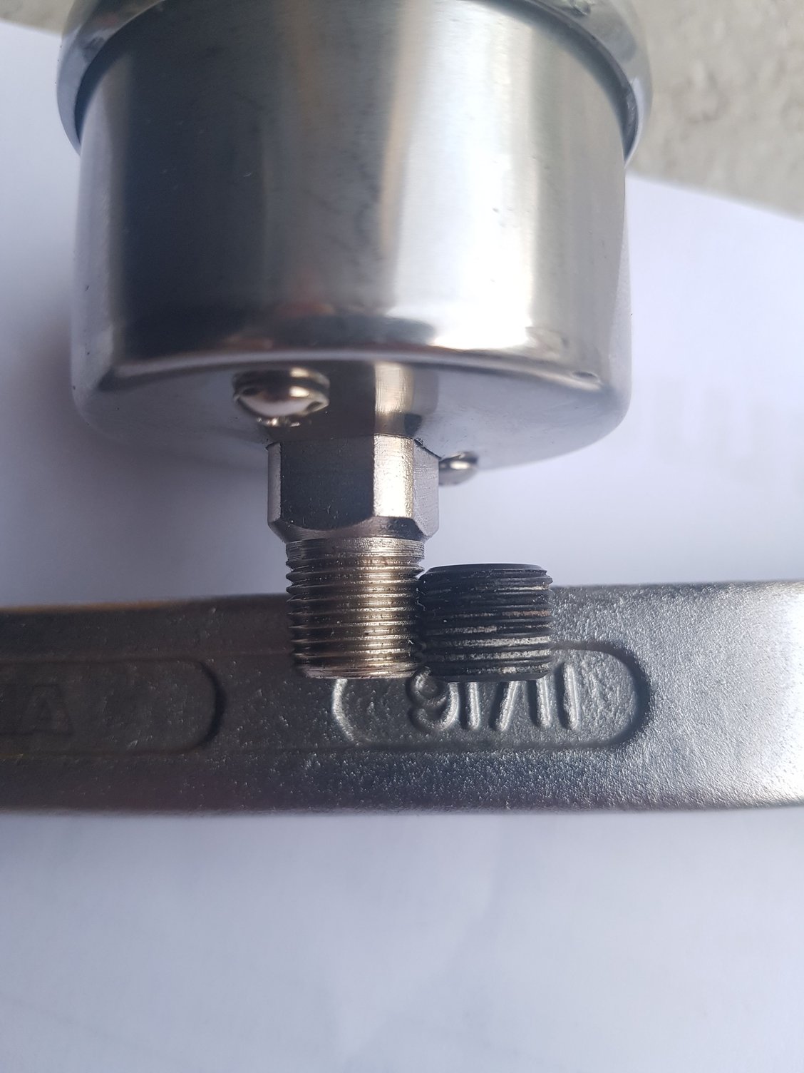

Here is the plug that works and the gauge that don't
Now taken the picture and being able to zoom in I see the threads don't actually align... 😊😁
That would then indicate that the plug and threads on the fuel line is NOT 1/8 NPT !!! 😔

I wish you did not have that black part in the background..
But when I did enlarge it. I swear it looks like the plug that came with your fuel line does not have pipe threads.
I do not think the fuel line is made for pipe threads myself. Jury is still out on this..but that is what I see from the photos given.

hmmm... looks like the threads line up. I can't imagine the threads NOT being tapered/NPT. Maybe goup it up and jam it in there and tighten awayl!

Yes, strange. I didn't think they made fuel line with gauge port in any other thread.
Or maybe someone re-threaded to different thread size.
So now I'm up for either invest in a new fuel line or skip the fuel pressure gauge all together or try to re-thread the threads in the fuel line.

Try this. Go to the hardware store and get a brass fitting that the fuel pressure gauge can thread into...then...take the Allen plug and see what happens if you try to install it in the brass fitting. If it locks up the instant you put it into the brass fitting...then something is obviously wrong.
If it did lock up. Then I would get out my tap and remove the line and thread it so I could install the gauge and not think twice about it
DUB

Yes, I'll go for that. Disconnect fuel line and redo the threads. Give it aatry and if it doesn't work then make investment for new fuel line.
