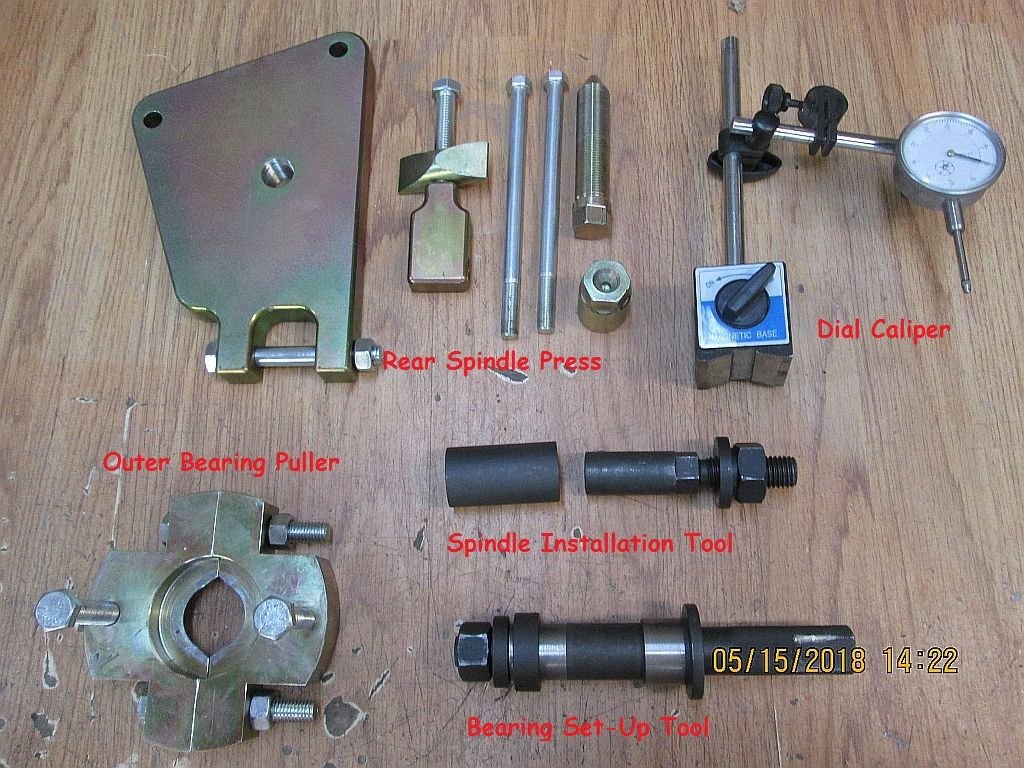

Hey guys. Exactly what tools would I need for this job?
Thanks. John.

John,
I just completed this job on my '76 a couple of months ago. Below is a picture of the tools I used, labeled for identification.
I would recommend you read up on doing the job before jumping in to completely familiarize yourself with the procedure. If you do not have the factory service manual for your car, buy one. It is invaluable.
Also, you do NOT have to remove the trailing arms to perform the rear bearing service. This service can be performed on the car with the trailing arms and rear spring installed. I would strongly recommend against removing them (trailing arms) unless you know for certain you have and issue which requires their removal.
Here are the tools needed:
To Rear main bearing seal's.

Nice photo of all the tools.
Here are some instructions for the spindles.

Hey orange. Thank you so much. That's a incredible photo of the tools. Very valuable!! Once again. Thank you.
John.
