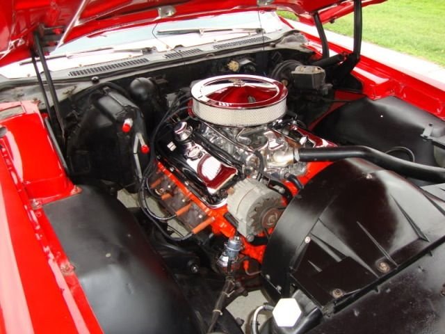

I have never seen a 69’ 2+2! I never knew they even made them after the mid 60s. Yours is gorgeous!!
Ironically, I also have a 69’ Grand Prix with a 454, 4 spd....my dad has owned it since 85’.
On the timing control thing, as good as I’m sure the aftermarket controllers do at controlling timing, I just don’t think it’s needed. A good setup distributor, with the correct curve, dialed in vac advance or running it “locked out” works fine.
No reason to reinvent the wheel. The 502/502 cam is very mild, the engine makes plenty of vacuum and will idle fine. Lots of people put FI on 502s.
