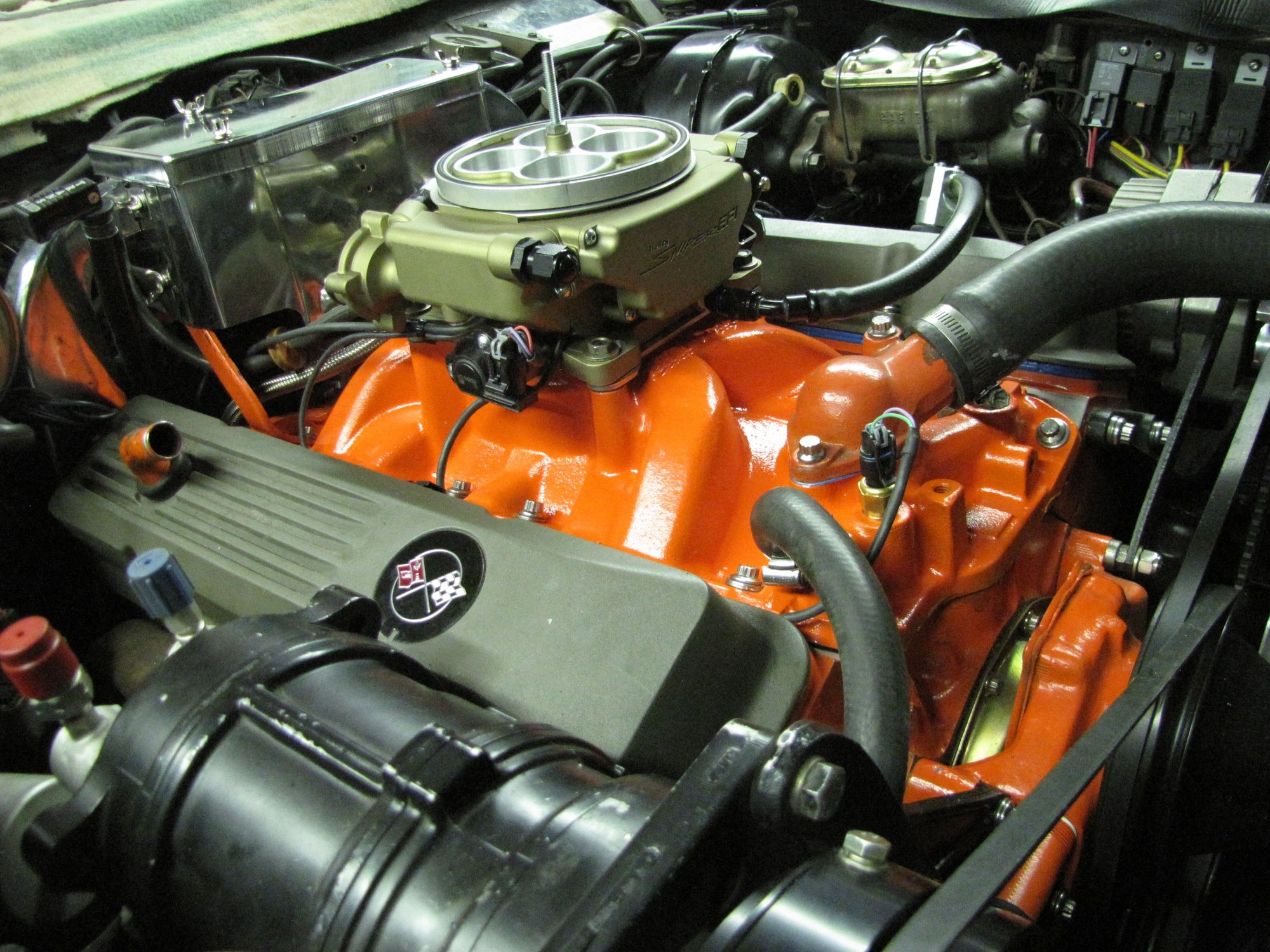

The 2701 fits under the stock SBC hood on my 69 with the Sniper EFI and stock air filter housing. I copy catted redcruz on his idea of using a fuel regulator mounted at the tank to eliminate having to use 2 lines, besides I don't think you can use the OEM filter with a return line off the EFI. T
NOTE; you'll see the 1/4 inch riser on top of EFI to allow use of OEM filter housing, and the capped port on right front was at the pressure regulator, also required for use of OEM housing.
