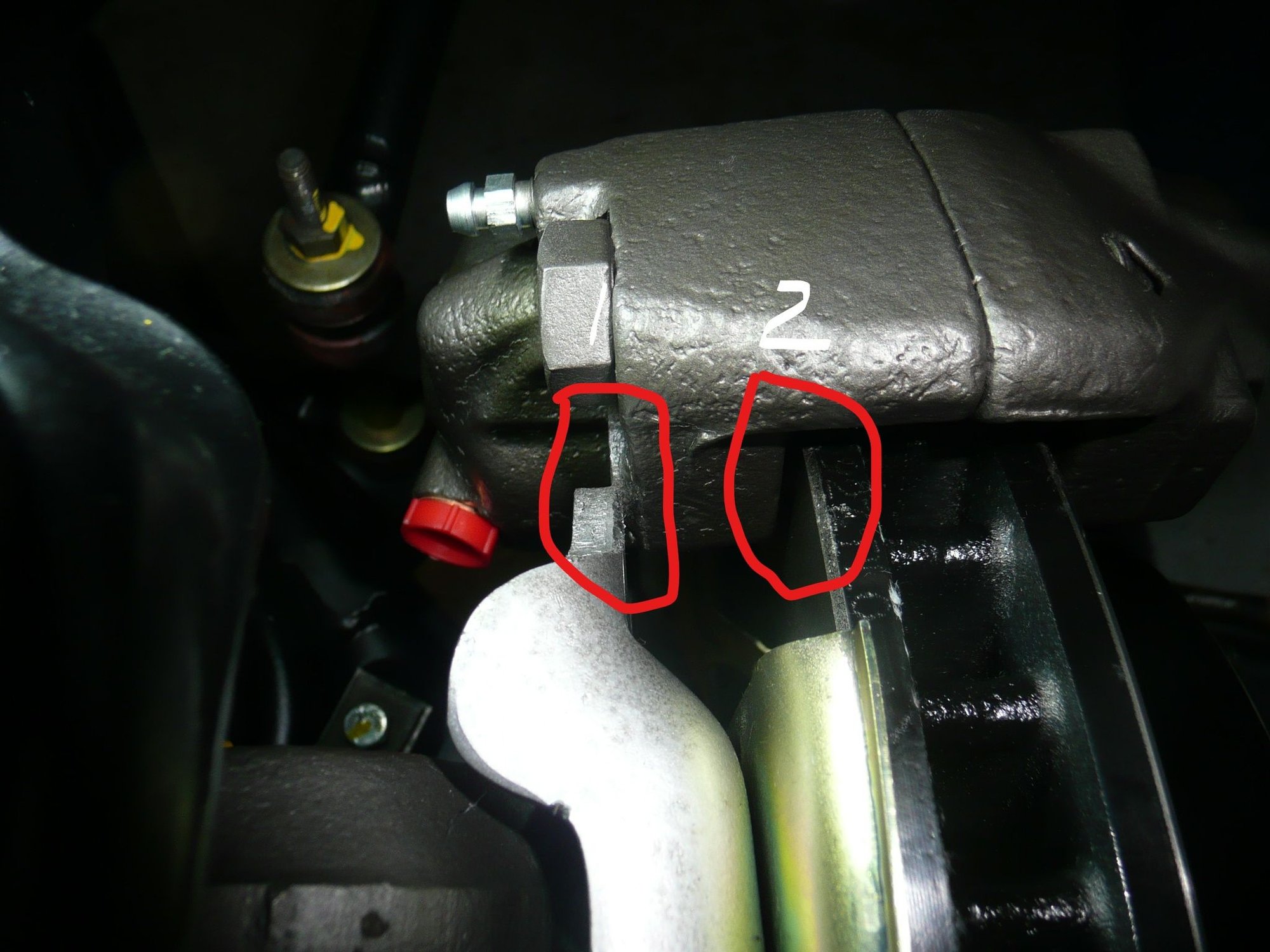

Trying to install the reman calipers on the front of my 79' and ran into a clearance problem. The caliper mounting flanges on the caliper won't fit the space between the bracket and the rotor. Left side fit fine, right side no-go. It appears that the new )made in China) rotors have the inner bearing pocket machined too deep which moved the rotor toward the mounting bracket. Circle 1 shows the boss on the caliper and the mounting bracket. Circle 2 shows the edge of the rotor and the inside corner of the caliper housing (which runs into the rotor). Any other ideas??

Is the backing plate of your brake pad FULLY compressing the pistons of the caliper....thus...not allowing it to allow the caliper to fit?
Try switching the rotors and verify that you DO have an incorrectly machined rotor if that is what you feel it is.

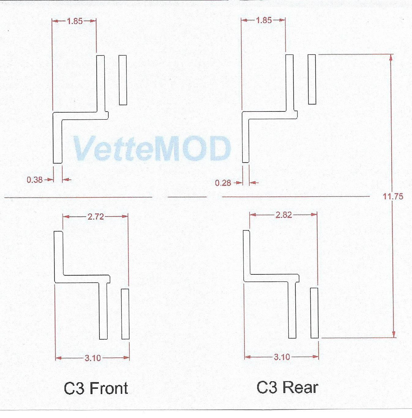

Front and rear rotors are different.
Did the parts store give you one rear and one front rotor?

The diameter and width are the same (11.75 X 1.25) but the dimensions inside the 'hat' are different front to rear.

Ah-Ha!! I measured the hat thickness on the new ones and it's .28, old ones are .38 so it appears they sent me REAR's instead of fronts. Since I need rears anyway, I guess all is not lost.

I had measured these along time ago on a flat piece of metal and they measured out the same. I was WRONG!!!

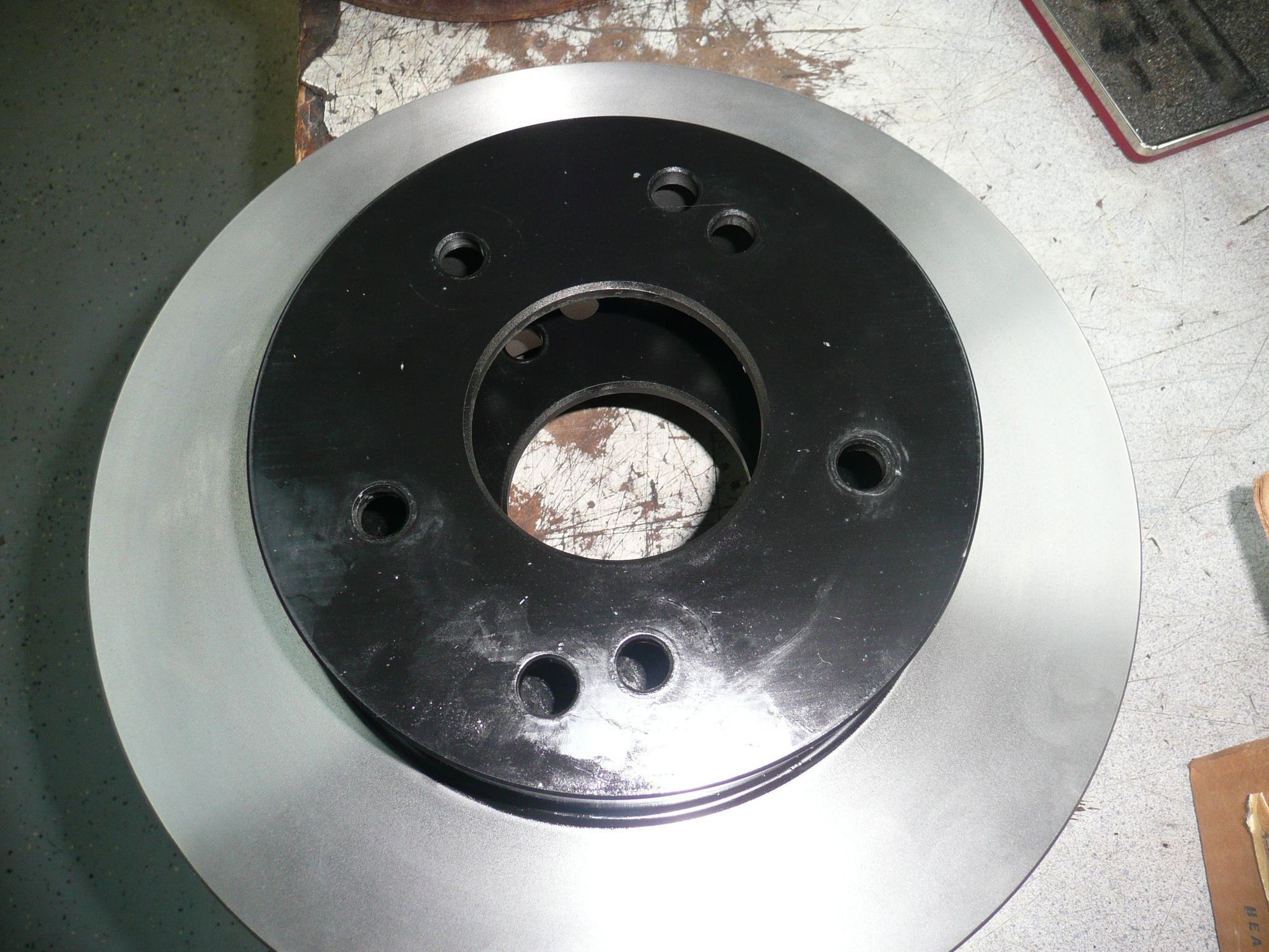

I am curious 'Duke94'. The rotor that is 'off'. Does it have the two holes that are drilled in it (opposite of each other) so you can adjust your parking brake adjuster??? OR...are there only 5 holes drilled in it for the wheel studs.
IF the rotor that is not working does NOT have these extra two holes in them. Then you cannot use it for the rear IF you care about your parking brake.

Hi Dub,
Yes, they seem to have the xtra holes.

YES..that is an instant indication that that is a rear rotor. NO mistake about it.
Problem FOUND.
