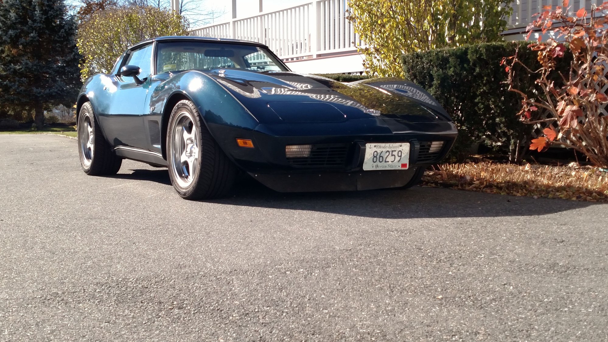

Here is my GM OEM 1979 spoiler extension that I put on my 78 in the early 90's...no metal strips. Has been perfect for about28 years............
Unless you want to be 100% OEM, in my opinion and after almost 30 years on my car, you do not need them.
I suspect GM put the strips there so they could use blind rivets to attach the extension. Without the strips the rivets would just pull through the stock air dam. With machine screws and a good size washer, that shouldn't be a problem. What did you use to attach your extension?
Aluminum screws and nuts...30 years ago....was tough to find stainless back then...still look perfect
