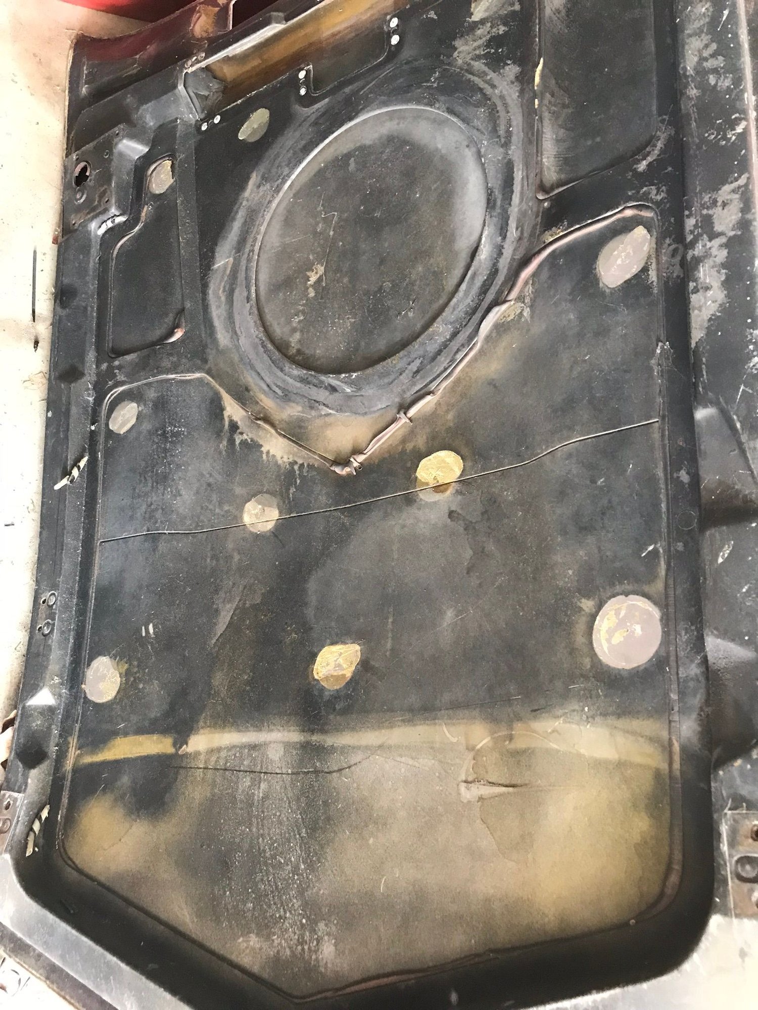

You can remove the prongs if all you need is the half inch or so space for your air breather. However, I removed the ones on my 73 with a heat gun. With the hood off, it takes minimal effort. I had a couple that were actually rusted and or missing a prong. Just going to sand and paint over.
