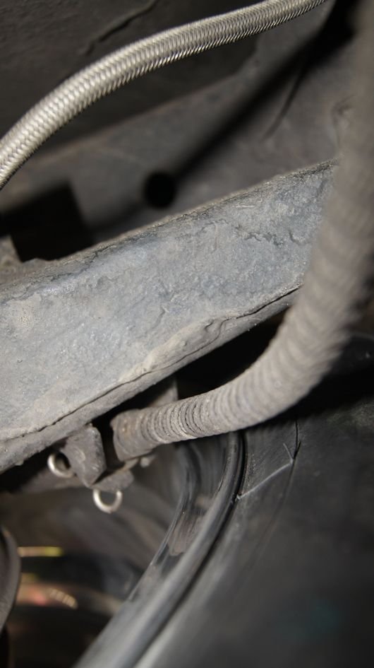

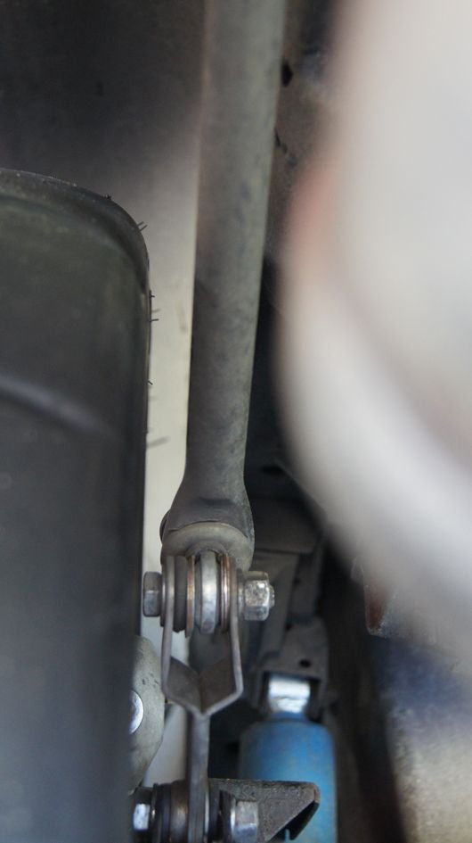

These are 275 40R 18 front and rear, with no modifications to the stock setup. ( spring / rear sway bar / e-brake cable etc)
Wheels are 18x9.5" with 4.75" BS -12mm offset. This matches the factory 15x8" with 4" BS -12mm offset and add's 3/4" inner & outer to the factory wheel.
You can check your car by measuring 3/4" from all points of the factory wheel to see if you will have any problems. With 18 or 19" wheels the e-brake cable is inside of the rims.
If you go more than 4.75" BS on a 9.5" wheel, then you might need to move the ebrake cable.
Here is the e-brake cable / sway bar clearance on my car.
