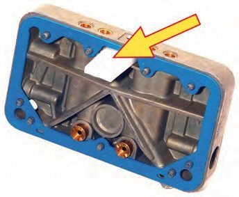

Check the carb and see if it has a "whistle" in it. If not, you need to install one. If the carb does not have a "whistle," you will get fuel slosh at steep angles which will allow fuel to slosh out the vent tube and down the venturi, causing the problem you describe. We have the same problem on transverse-mounted Holleys on road race cars, which will pull enough lateral g-force to cause the same issue if a whistle is not installed.
The white vent extender is called a "whistle":
Lars
