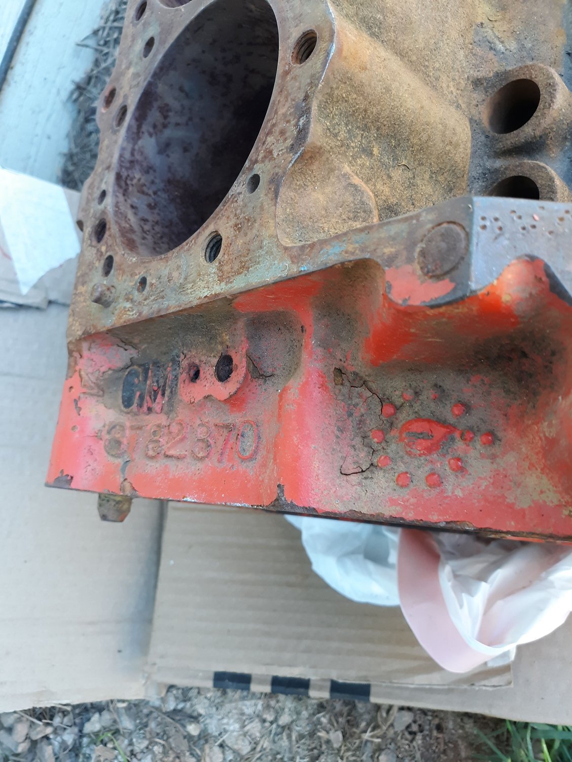

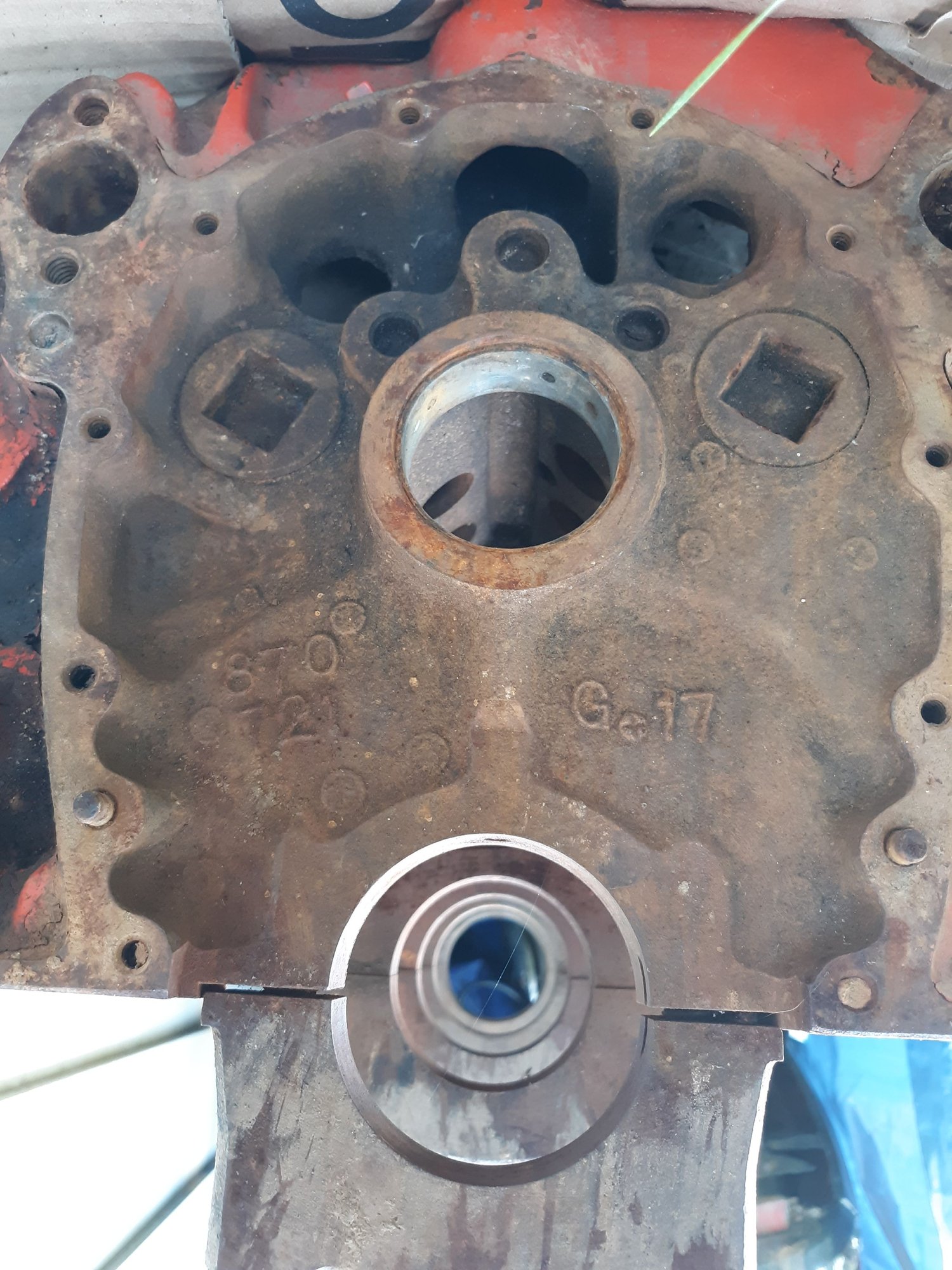

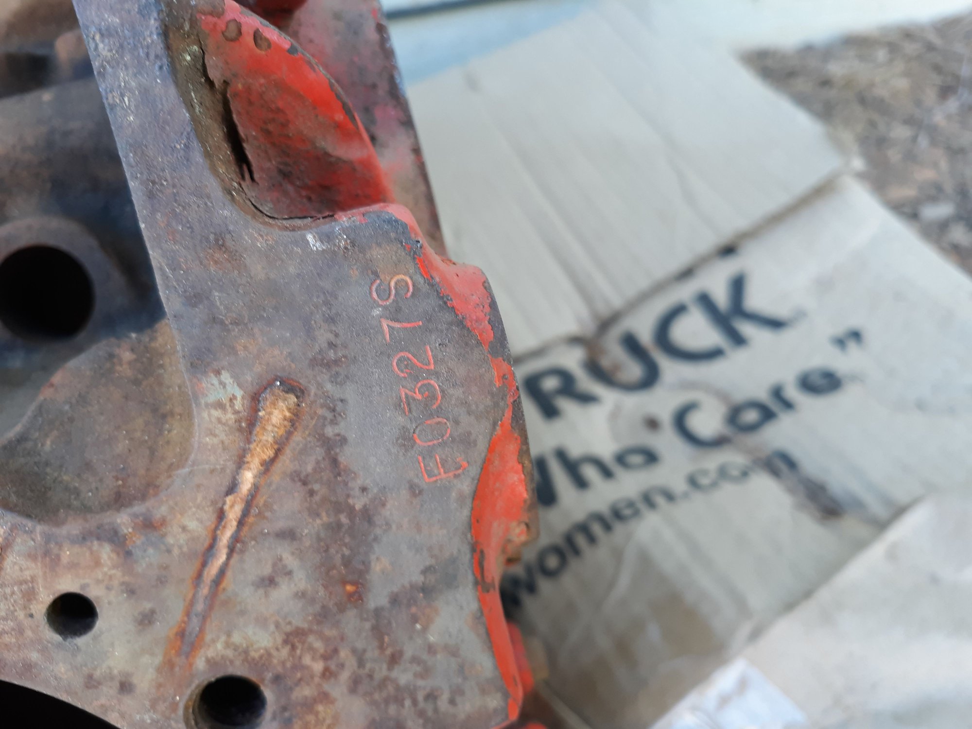

Default Please Help Me Identify This Engine Block
F0327S
Hi my name is Aaron Gragg, I'm from Asheville NC iv found an old chevy engine block but I need help with finding out what it came out of and maybe some other stuff like hp and what not I'm going to attach pics Someone please help
Old Apr 16, 2019 | 01:06 PM
  #33
DAD111's Avatar
DAD111
Joined: Aug 2018
Posts: 252
Likes: 48
From: Cincinnati, Ohio
Aaron you should start a new thread for better/ quicker response FYI - Its a 327 250hp to 375hp. Depending on the heads and pistons/ Intake - Car or truck 1962-1965
