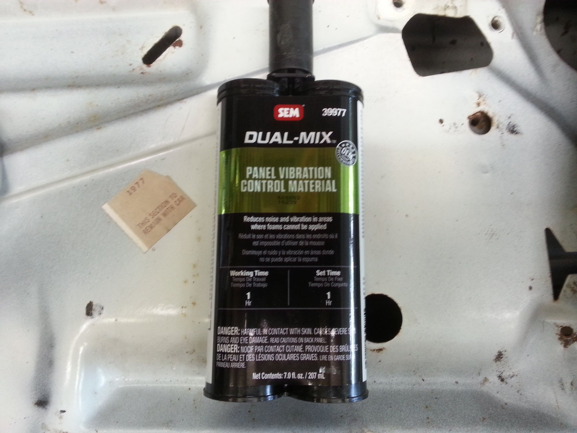

This is what I am going to use epoxy/polyurethane strong and a little flexible.

Body and paint job stores sell the two part adhesives. Plastic to metal and fiber glass to metal. what I have used was black. It usually is pretty spendy. I've glued Vette doors and the metal tabs to new bare hoods. the strong stuff is not flexible

I am sorry to get to this too late. I would use the SEM BEIGE CATALYZED SEAM SEALER.
Hopefully you did not use the product that had shown in the photo to actually bond the panels on with.

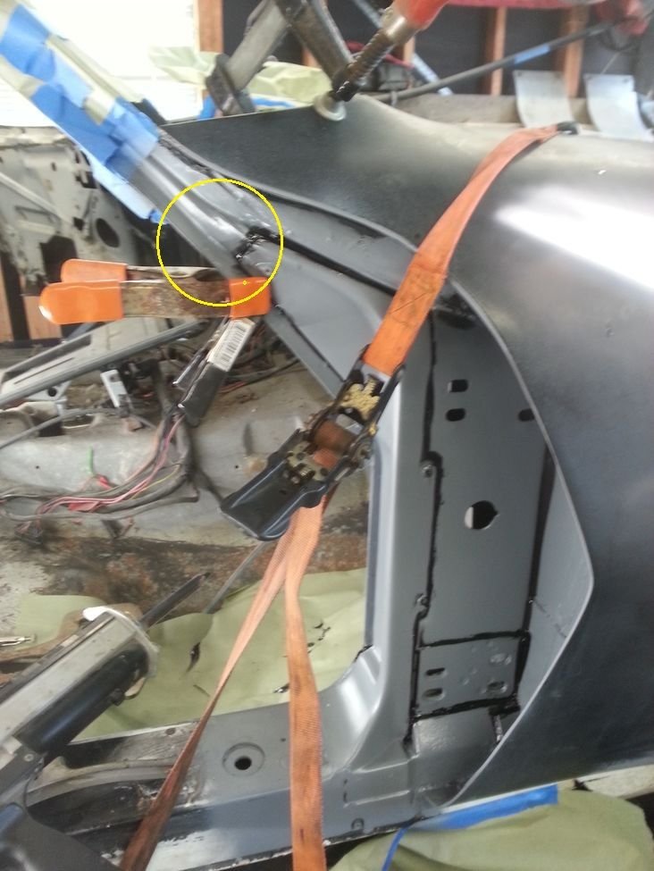

FOR WHAT IT IS WORTH:
In your photo below I put a yellow circle. At this is the transition from the end of the fiberglass panel where it meets the steel pillar post. It is WISE to use the flexible seam sealer and make that transition be as smooth as the rest of the area where you know your w/strip will contact. If you leave it like you have it with that 'step' in it . It will cause your w/strip to shed up in time.

The stuff I used is flexible and it will be smooth
