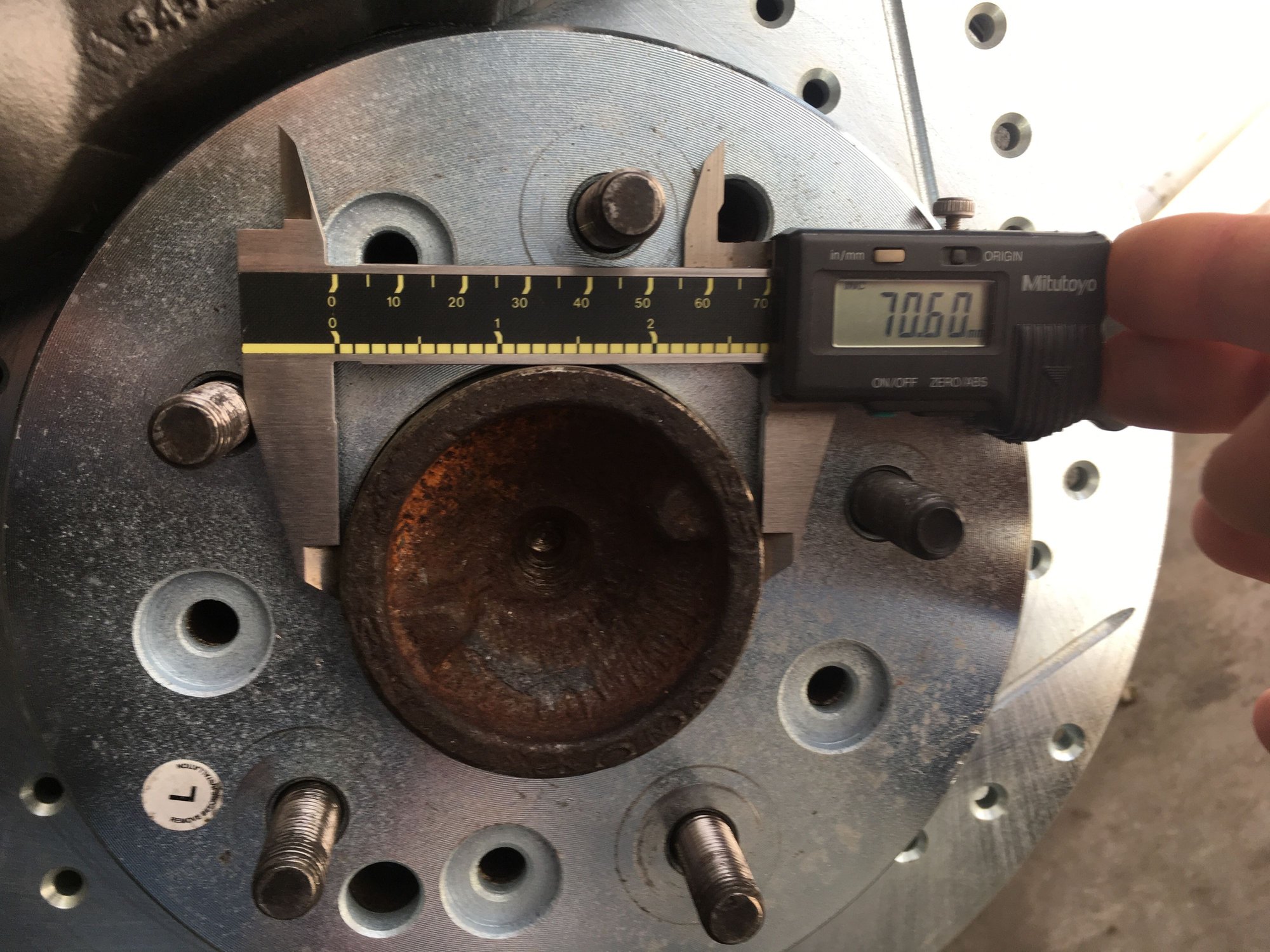

Old Jun 12, 2018 | 02:06 PM
Kie's Avatar
Kie
Joined: Mar 2018
Posts: 526
Likes: 113
From: Seattle WA
Old Jun 12, 2018 | 02:20 PM

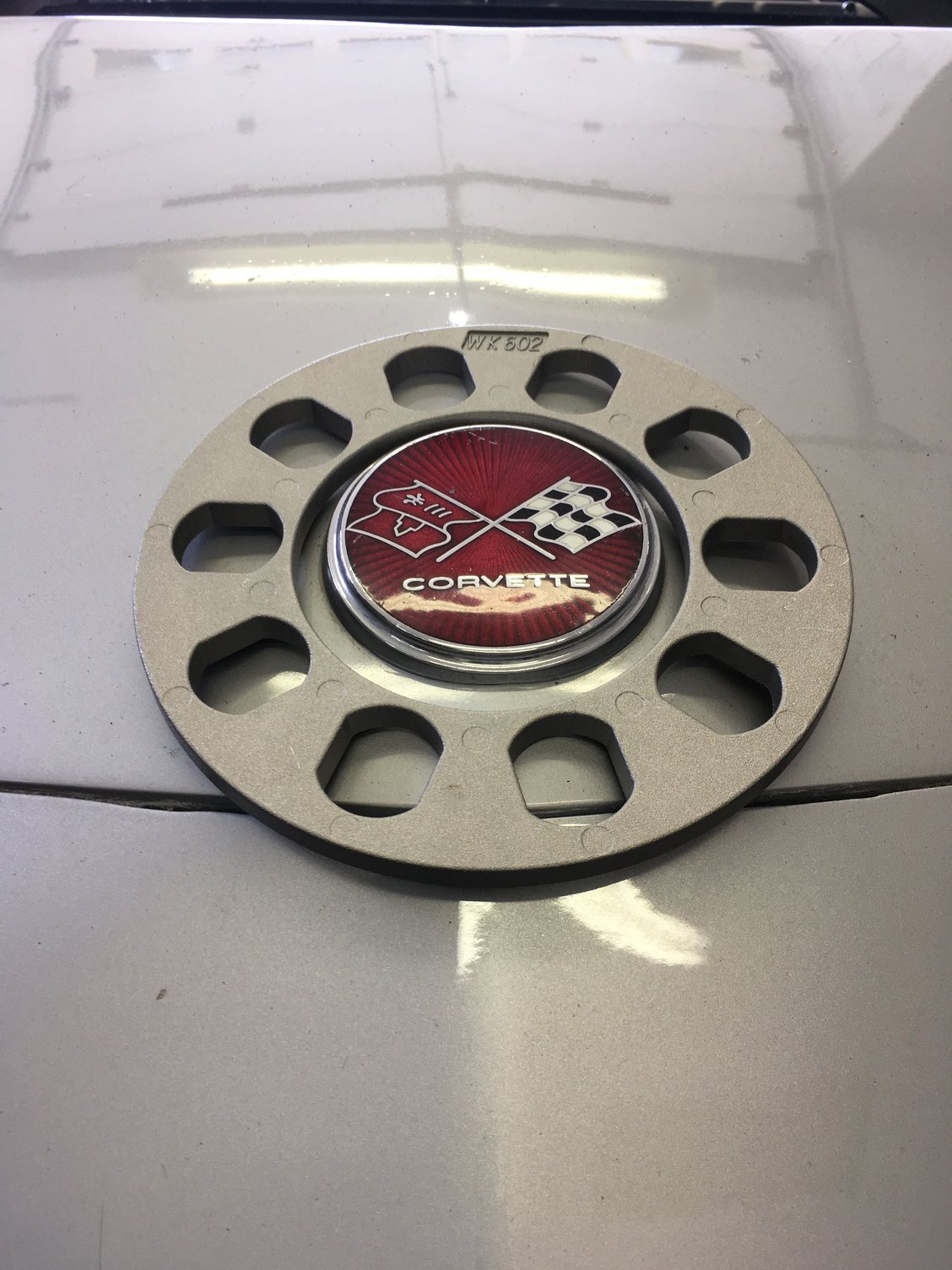

Old Jun 12, 2018 | 02:30 PM
69autoXr's Avatar
69autoXr
Joined: Jan 2004
Posts: 3,247
Likes: 210
From: Detroit MI
go to motorsport-tech.com and you can order exactly what you need
Old Jun 12, 2018 | 03:13 PM
Kie's Avatar
Kie
Joined: Mar 2018
Posts: 526
Likes: 113
From: Seattle WA
Default Go with the best. Dorman !
I keed I keed. These are mock up units only.

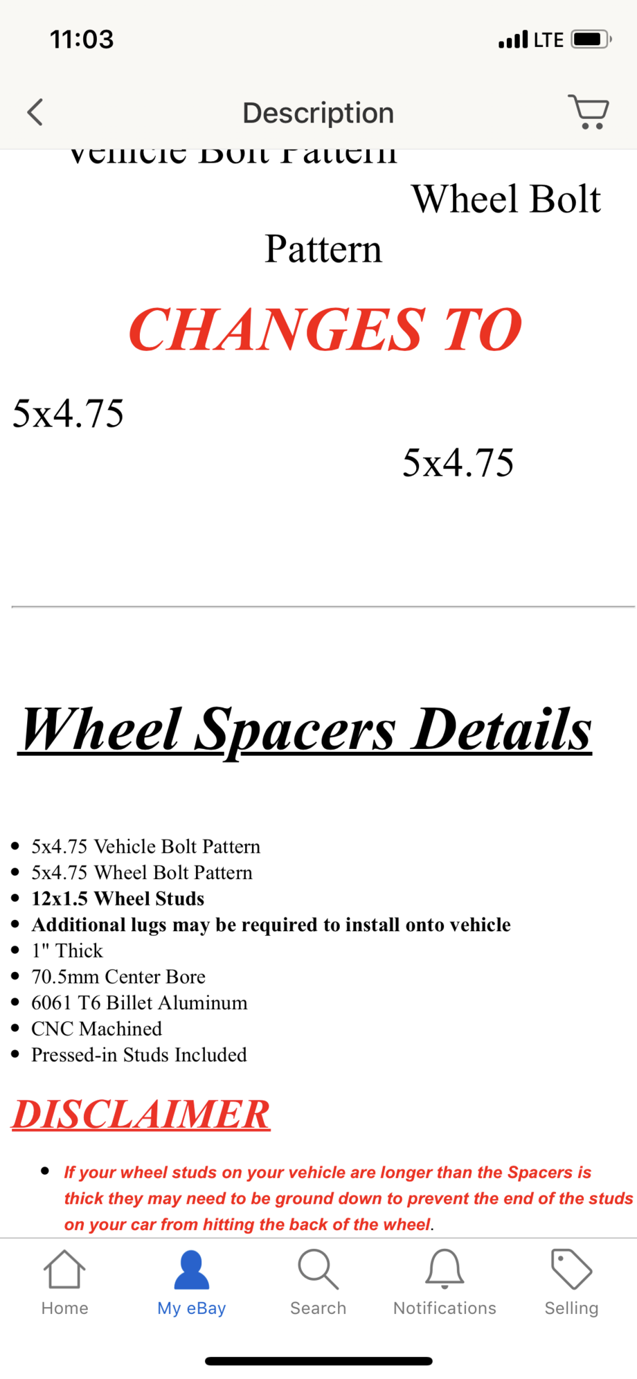

That place quoted me $325 for the set, a lot more than I expected for a set of spacers.
Would the attached ones work just as well?
Old Jun 13, 2018 | 02:37 PM
69autoXr's Avatar
69autoXr
Joined: Jan 2004
Posts: 3,247
Likes: 210
From: Detroit MI
Sounds like you're looking for adapters rather than spacers. The bore on those above is too tight, you'd have ~0.002" interference at the radius. I'm not a machinist but I don't think you'd ever get it to go on.
edit: I think for a press fit you'd be looking for ~0.0005" interference across the diameter, this is approximately eight times that interference across the diameter.

I don’t want adapters. I just need spacers to push the wheels out more since they have 6” backspace
Old Jun 13, 2018 | 02:53 PM
69autoXr's Avatar
69autoXr
Joined: Jan 2004
Posts: 3,247
Likes: 210
From: Detroit MI
Ok, I was going from the photo you posted which appear to be adapters (1" thick with pressed-in studs).
How big a spacer do you want? I had motorsport-tech make me 10mm hub and wheel centric spacers and they charged me $70 for the pair in 2012.

I’m looking to get 3” in the rear and 1.5” in the front. The wheels I’m getting are 18x10.5 with +25 offset and 6.34” backspace.
I need some beefy spacers to get them far out enough to fill up the L88 rally flares
Old Jun 13, 2018 | 03:07 PM
69autoXr's Avatar
69autoXr
Joined: Jan 2004
Posts: 3,247
Likes: 210
From: Detroit MI
You need adapters to get that kind of thickness. Bolt adapters to the hub, bolt the wheels to the adapters.
Maybe check the classified ads to see if anyone has something similar for sale.
Can't you get wheels in your size that are closer to or have the correct backspace?
Old Jun 13, 2018 | 03:11 PM
titanle's Avatar
titanle
Joined: Jul 2013
Posts: 963
Likes: 57
From: Vancouver, BC
Sorry I got confused for a moment. Spacers have holes for the existing studs and they just push out the wheel a little
adapters have a new set of studs which the wheels would bolt to and the adapter would mount to the car.
so yes I would need adapters. Any place to get them at a decent price?
Old Jun 13, 2018 | 03:16 PM
69autoXr's Avatar
69autoXr
Joined: Jan 2004
Posts: 3,247
Likes: 210
From: Detroit MI
Not that I know of, I haven't looked at buying adapters in almost 20 years. I bought mine at VBP but I don't think they carry them anymore, and they were probably in the $300-400 range at that time for a set of four.
Old Jun 13, 2018 | 03:29 PM
titanle's Avatar
titanle
Joined: Jul 2013
Posts: 963
Likes: 57
From: Vancouver, BC
They’re selling for the same price now. But in the long run I think it will work out cheaper than getting a set of 12” wide wheels and paying for 3xx wide tires
