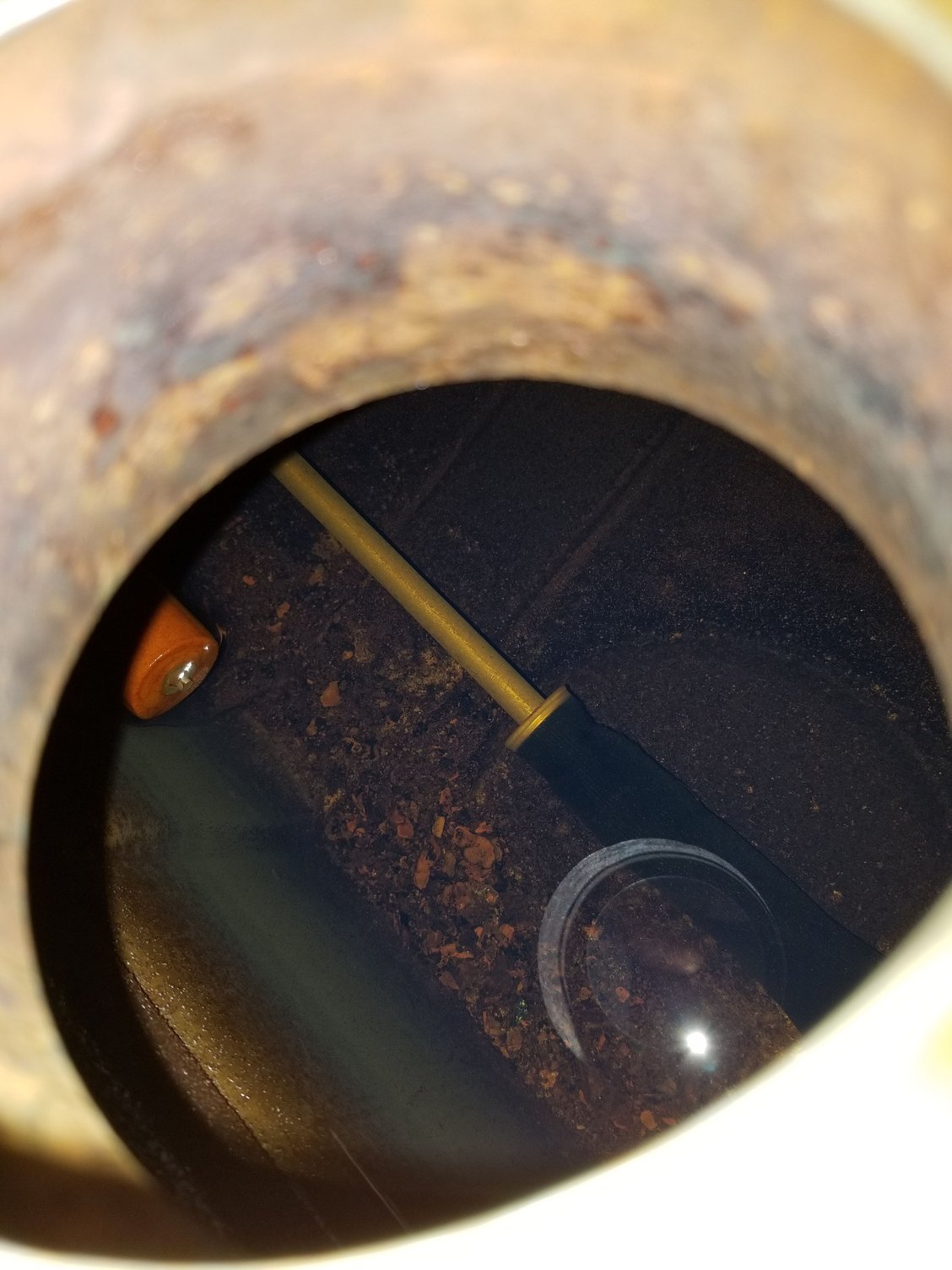

Anything I can do about rust in my gas tank outside of dropping the tank and replacing it?
If not, how bad is the tank dropping process?

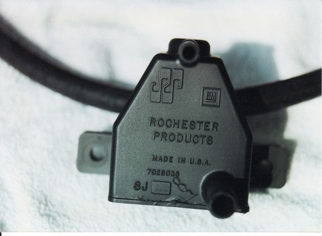

If you do remove the tank, be sure to check out the FUEL SEPARATOR VALVE on the top, left corner of the tank. These do deteriorate over time and begin to leak. The plastic gets brittle and it isn't unusual to break the nipples when removing the rubber hoses. The good news is that they are now being reproduced. Considering old originals in unknown condition were bringing $75 at swap meets a few years back, $50 for a brand new one seems like a good deal.
photo courtesy of Alan 71
https://www.paragoncorvette.com/p-35...tor-valve.aspx
Good luck... GUSTO

For what this is worth:
I have seen fuel tanks that look like this and an awful lot of trust is being put in the integrity of the sock filter that is on the sending unit. Hopefully shows that it has not been torn at any time.
I also look at how the inside of the tube of the sending unit looks. I have seen them very rusty with a lot of scale and that can cause for a fresh fuel filter to get plugged up rather quickly. Which ahs happened to me on some customers cars where a month later of consistent driving...the fuel filter when removed and broken open showed it to be plugged up.
I also advise on fuel system like this IF the integrity of the steel fuel line on the frame by the fuel tank and the sending unit tube is rusty that the fuel pump also be changed out due to rust particles can collect in the bottom of the reservoir of the fuel pump.

My '72 tank looked like that and very soon afterwards started leaking. Stir the rust up with a stick I bet you end up with fuel in the ground.
