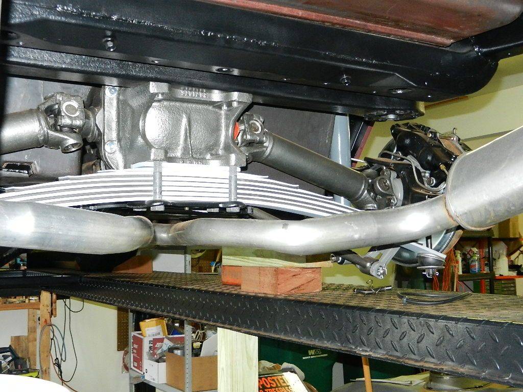

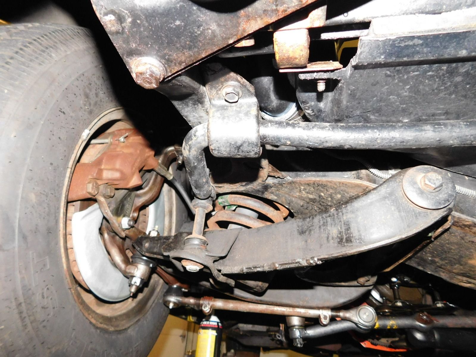

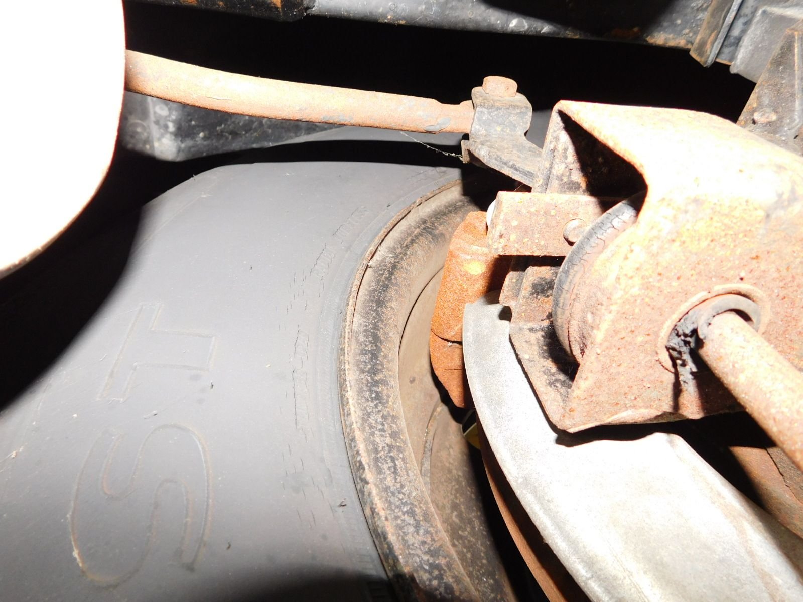

Restored pictures are a '70 LT1. Survivor pictures are a '72 454 car.
