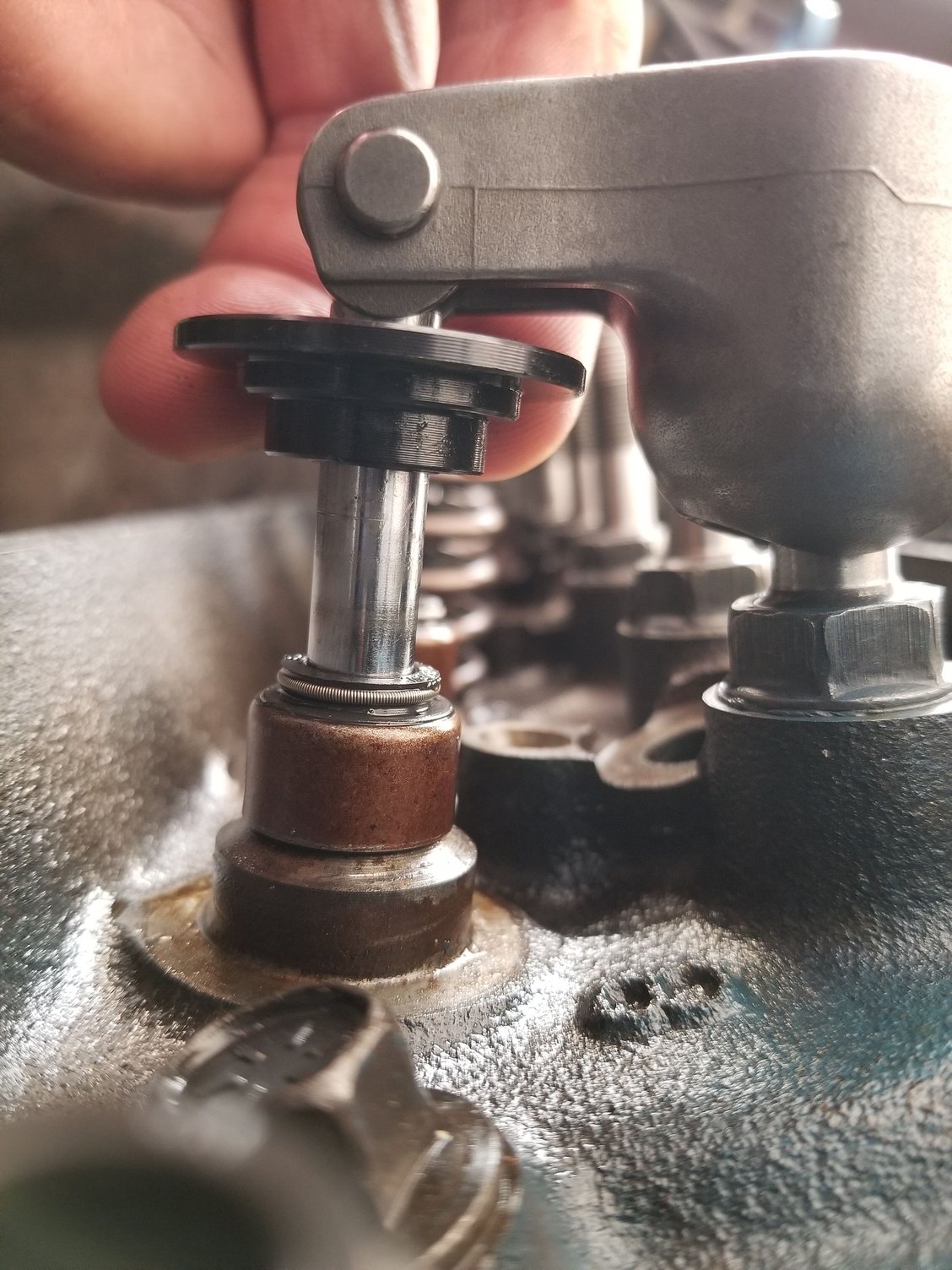

The valve seal is .850" from the spring seat.

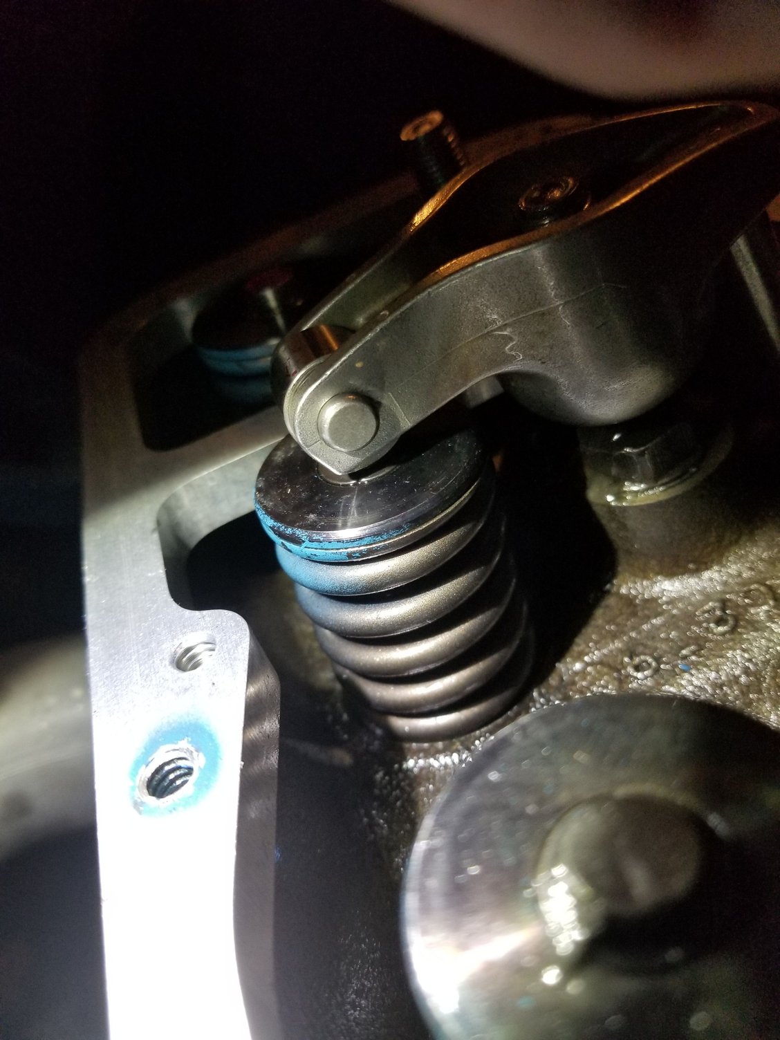

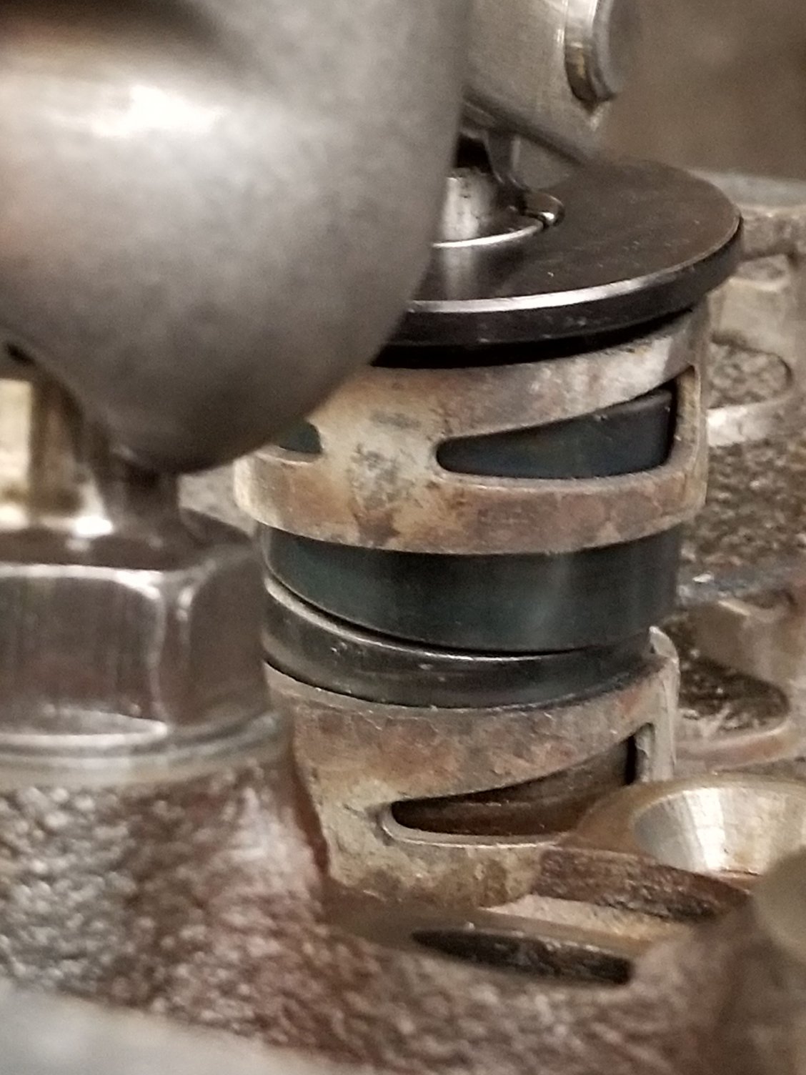

Long shot, but do you have these installed? I can’t really tell from pictures.

This is the spring at maximum lift at .525" with 7.18" stock pushrods. The valve seals are completely unscathed with a clearance of .050" between it and the retainer at max lift. This was covered in posts #3 and #19.

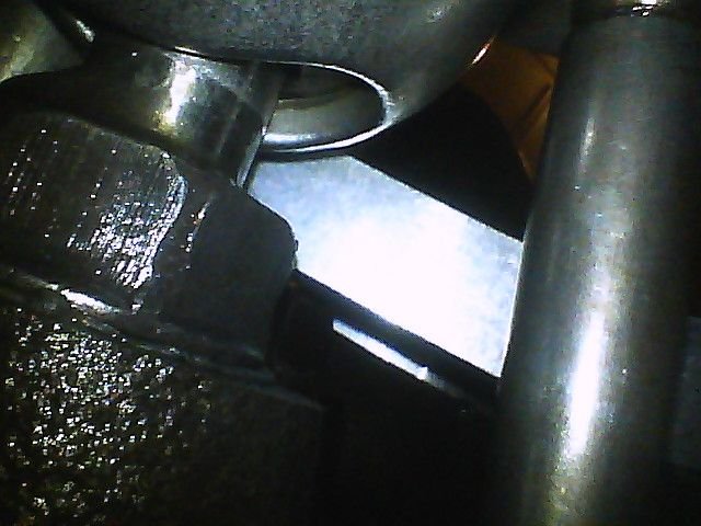

Rockers bottoming on studs in slots?
Yes sir, the rocker ***** are in place.
JIM
I thought the same thing too. The bent rods actually happened with the stock self aligning 1.5 rockers. I bought the 1.6 self aligning Comps because I thought that the small slots of the factory. The marks you see on the stud are from when the rods bent and the rockers laid over and rubbed the studs.
rockers were causing the bind. However, I did the same thing with the 1.6s. Here is a pic of the Comp rockers at valve seated and max lift.

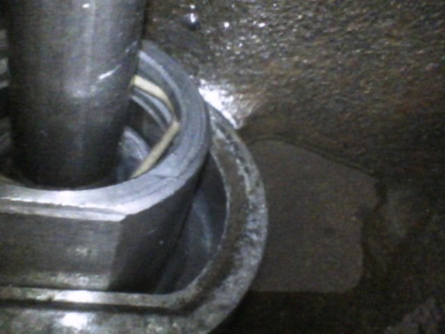

How would I do this? Wouldn't the valve seals be smashed if the retainers were making contact? Im not trying to be lazy, Im just very limited on tools and time.

At max .525 lift. there is .11 distance between the retainer and the seal.

That looks like it clears.

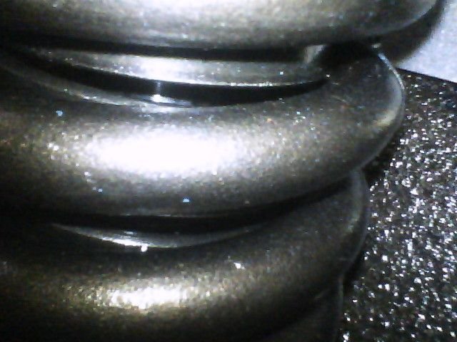

Check the inner spring for bind?

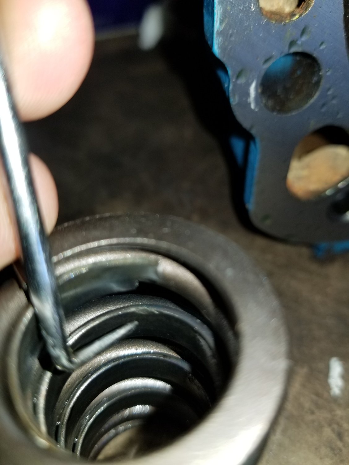

From: Midland TX
After seeing the massive amount of pushrod recession in the lifter at max lift, I decided to focus on the inner spring. I noticed some contact marks on the I.D. I then removed the inner spring and installed it using hose clamps to replicate the outer spring on the top and bottom. From the pics, you can see some serious coil bind. I think we may have found the culprit.
