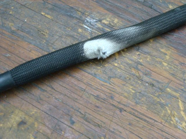

I was just searching for AC R44T plugs for '73 350, 190 hp. (Have not changed to HEI yet, but considering) I read a review about fittment with headers being a problem. That even if you get the pug installed, the boot is too close and will likely burn due to excessive heat. Has anyone had this issue? If so, how did you solve the problem? Are there other plugs that can be used? Thanks for any help I get.

I ran Moroso Ultra 40 wires under my headers for awhile. I had to use the boots to cover the plug ends also due to the close clearances.Those are some heavy duty wires. I would highly recommend them. I burnt a few wires and decided to get my next set to route over the valve covers. I'm using the Davis Unified Ignition "Live Wires" now. I'm having no mores issues with the new wires. I liked the look of them but they are no way as heavy duty as the Moroso Ultra 40s.
h
