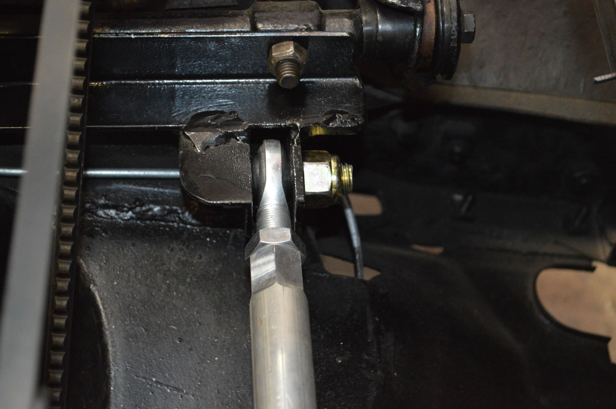

Originally Posted by 73ls1
Will a spreader bar help prevent cowl shake in my 73 convertible ? When I run over a manhole cover or hit a bad bump the car shakes. I have the Van Steel coilover system with Ridetech shocks.The shocks are set on soft settings. I don't want to spend $20,000 on a modern stiffer frame. Any ideas? Thanks Charlie.
You have had a lot of suggestions about adding a spreader bar. It may not cure all of the shakes and rattles, but it does stiffen the side-to-side cornering of the car. Like a number of other posters, I made one from heim joints I purchased and from some threaded rod and scrap steel. It cost less than $30. If you have removed the stock belt-driven fan, there will be plenty of room to install it.
