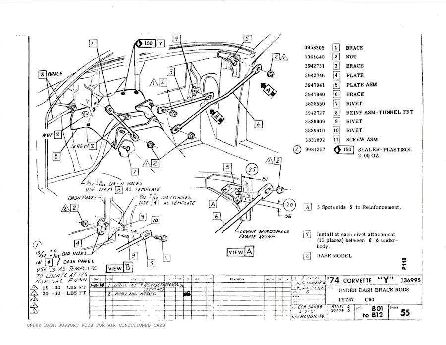

Hey Charlie-
DO- check the braces as "Peterbuilt" mentioned.
IIRC you have the vintage air- It does require modifying ( or maybe just removing...) the braces to fit the vintage air.

I have #6 brace but not installed.The car has vintage air so I need to modify the brace.My 73 has a LS1 and I need to make a spreader bar that clears the lower radiator hose.

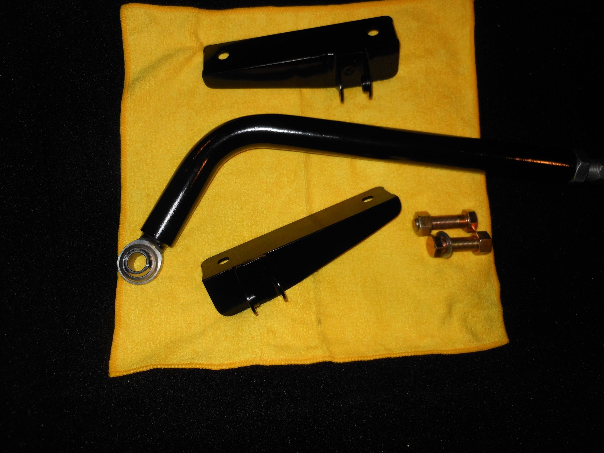

I used a Panhard bar from Speedway motors - on their 'Garage sale"- like $50 as needed a curved bar to clear my dry sump pump.
Some angle iron, bolts and a can of spray paint-

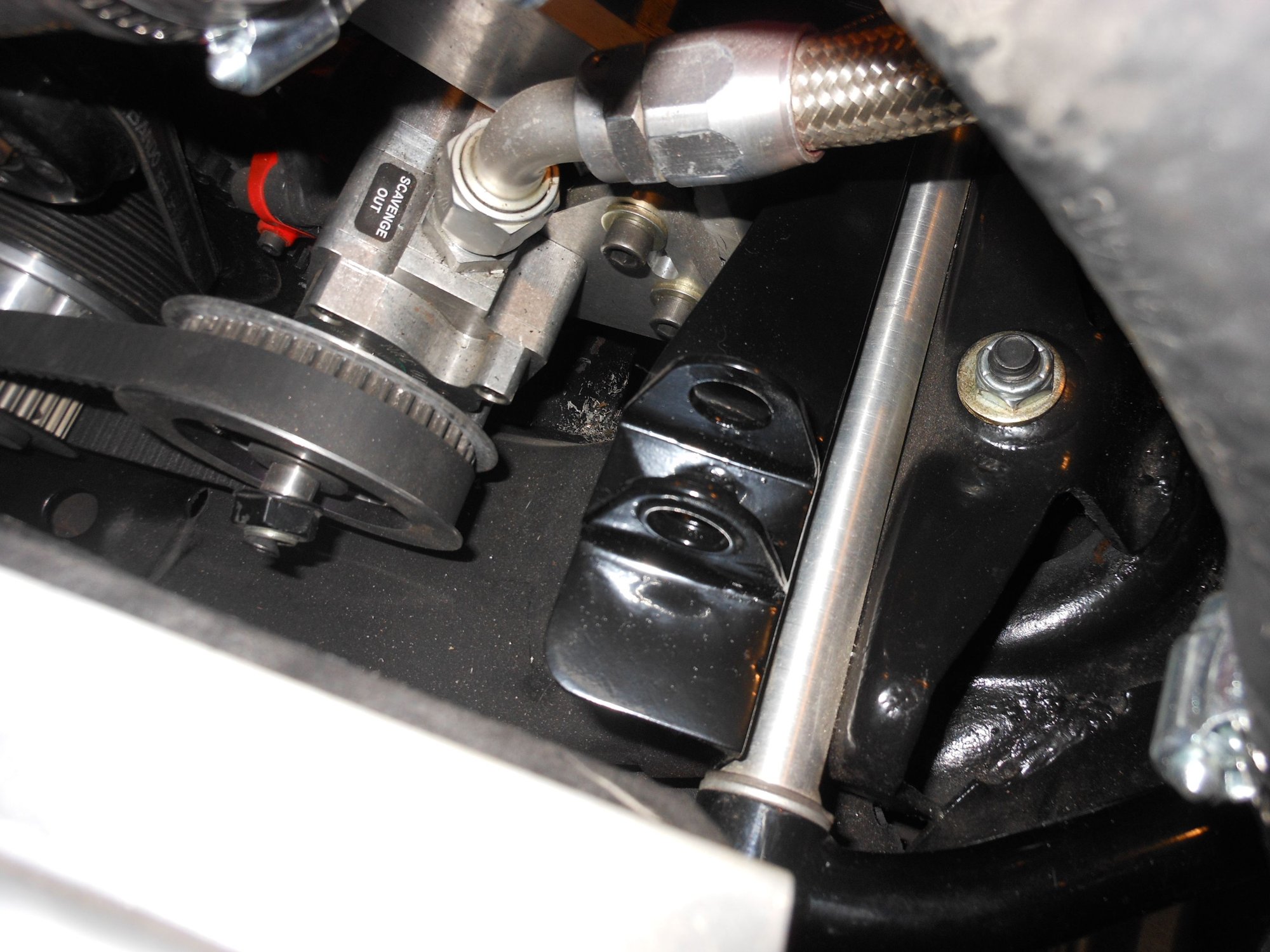

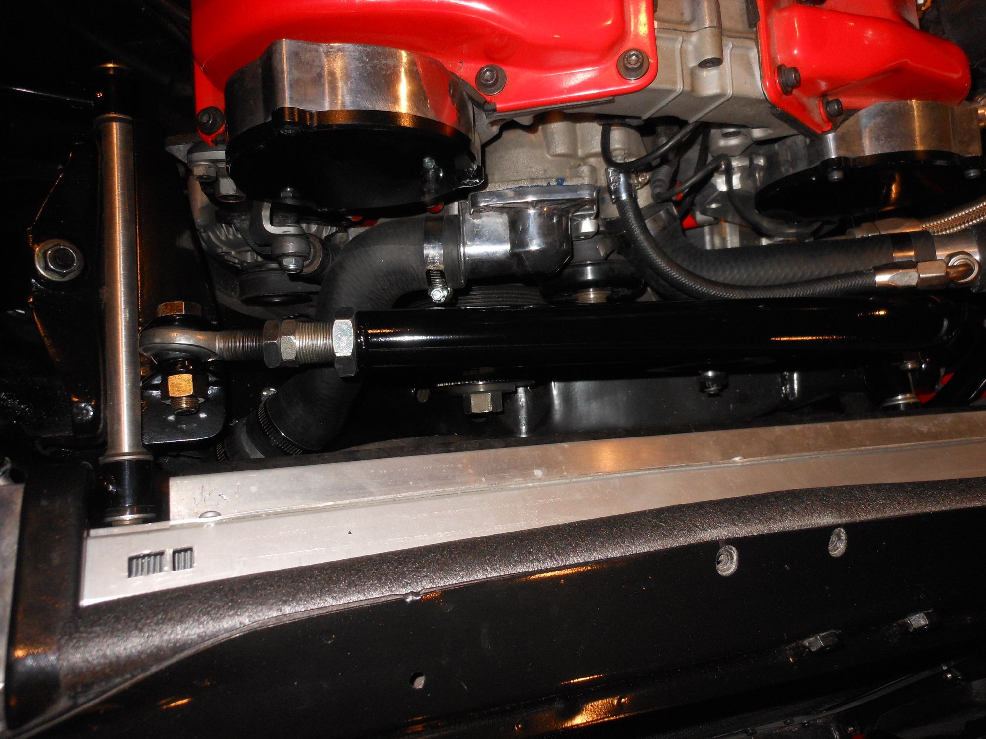

I'm running a vb&p spreader bar and plenty of clearance with my ls3 swap. In fact i had less room with the old 383 sbc and serpentine setup. Easy install. Hope this helps and good luck.
ls3 w/ vb&p spreader bar
sbc w/ same vb&p spreader
