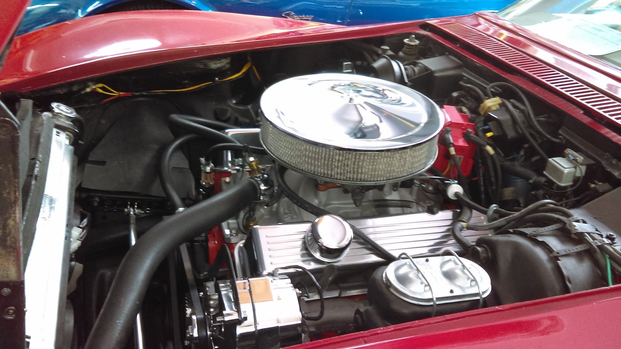

Originally Posted by '75
Those shafts are available from your local parts store, Moog problem solvers. I am using them with the holes slotted 1/4" and slid to the rear like 427 said.
Moog K6104
I used the MOOG problem solvers and they work great on My 71 with no issues. I also installed a spreader bar / stiffener for the front end, as I do a lot of high speed driving.
It's the silver AL bar in the picture.
