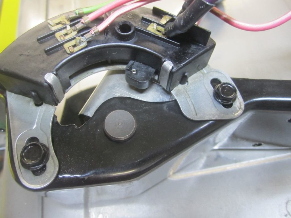

If so, press the button and pull it back towards 2nd a little and see if it still starts, or even all the way to second. If it doesn't then you can adjust the switch a little. Where it mounts to the shifter it's slotted and you can rotate it some to get it to be in the correct location.
That's from a 72 but the switch is almost the same
