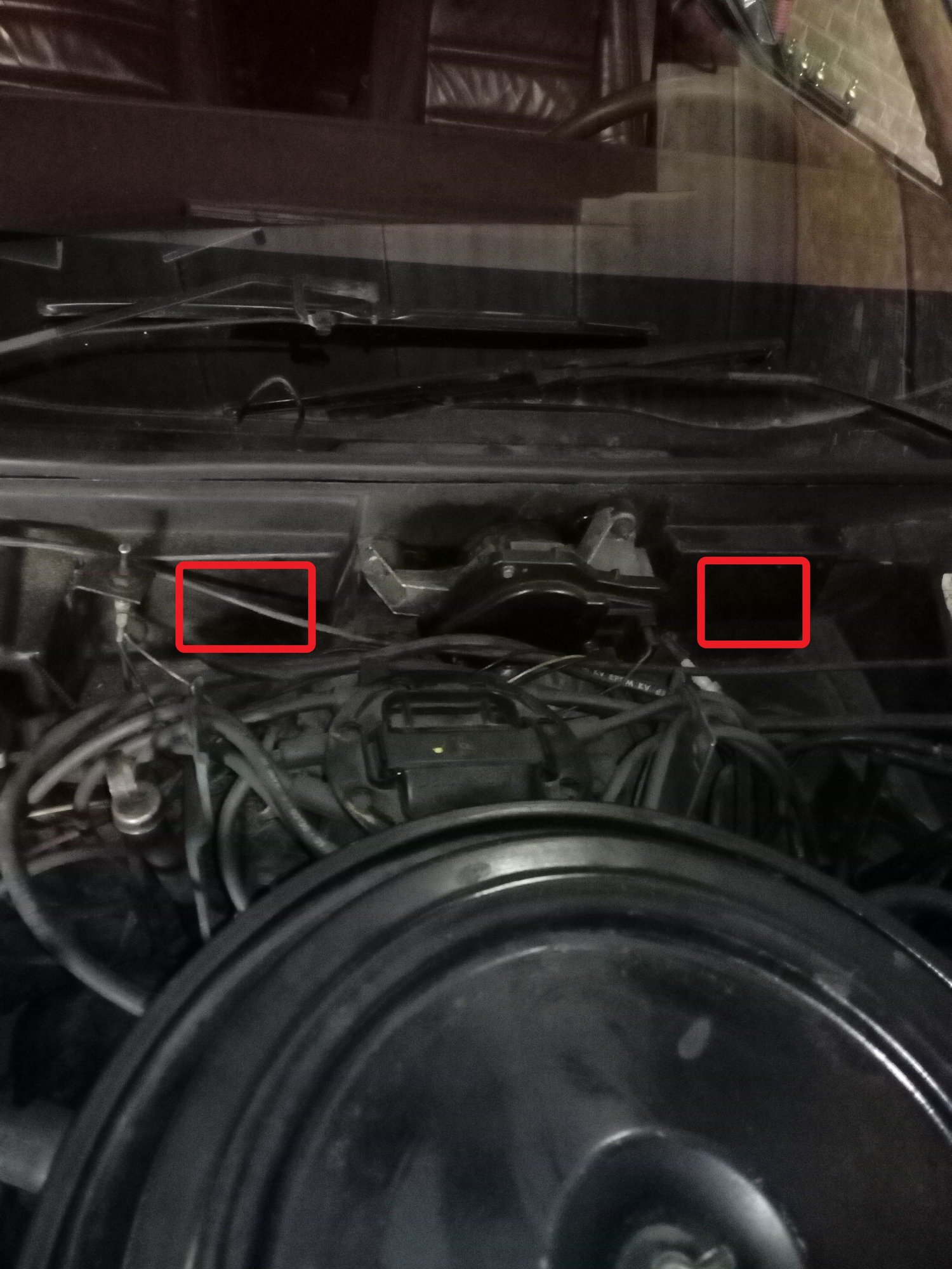

I got another idea I was thinking about this morning:
Would it be of any effect if I make two square vents at these two places on the firewall (and install a grill on both holes of course)? (see photo)

Hey Novusuhu, I agree that our C3s tend to get pretty dang hot under the hood! It seems a lot of air piles up under the hood with no where to go.
I liked your idea to cut the cowl, but that being said, I'm not sure how well it would work. The cowl area at the base of the windshield is a high pressure area (thus how "cowl-induction" intakes work). The reason the C7 style vents work is the area just aft of the nose is a low pressure area. This essentially sucks the air out. I suspect the cowl area, being high pressure, would/could prevent air from escaping.. or perhaps even allow some back flow into the hood area, perhaps making the problem even worse!
Check out this CFD of a NASCAR, which shows the low pressure area roughly where the C7 vent would be, and the high pressure area at the base of the windshield.
