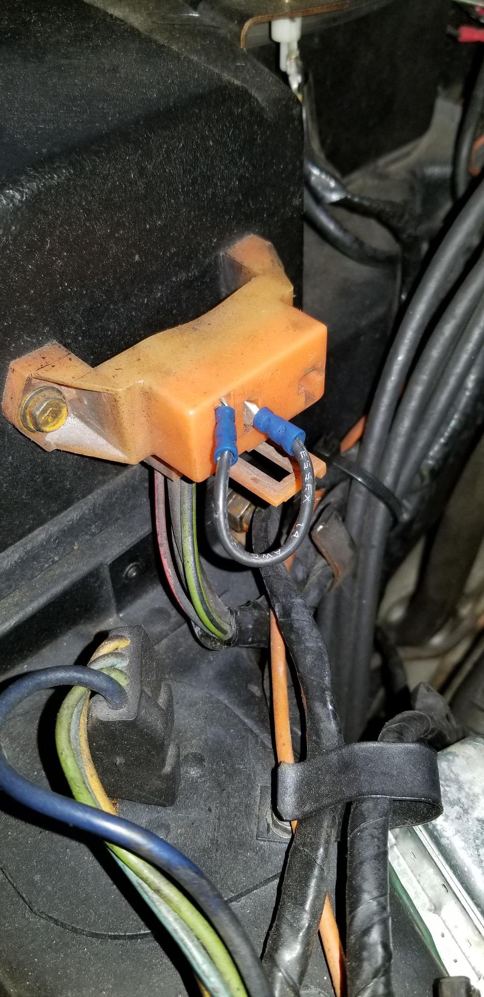

It’s this little doofer, it resets the seatbelt safety system that can get it’s knickers in a twist.
Ah. My car's a bit of a Frankenstein - it's a 74 with a 70 LT-1 in it. I'm assuming this means that the button was bypassed:
I reseated that cable and tried to start it again - it attempted a very feeble start so I'm assuming it just doesn't have any juice. Now I have to figure out why the battery drained in the first place.

Ah right, yep looks like it. Only reason I mentioned it was when I took delivery of my 74, with a flat battery, that button needed resetting, fired straight up after.

Your starter interlock has been bypassed and not a problem if the jumper wire is making a good connection.
