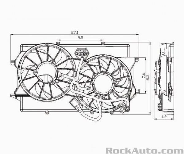

Originally Posted by fede
I've been told that the Ford Focus dual fan blower (like FO3115156) fits nicely.
And easy to come bye in Europe also! Will look into it!

How wide is the main body on those Ford Focus Fans? That would be good to know from somebody that actually has that assembly.
Old Jul 11, 2018 | 03:58 PM

Thanks, I saw that, but I'd be lopping off the supports (like I did on my Mark VIII) I did a rough estimate from the dimensions shown and I come up with about 24.6" to 25" from vertical edge to vertical edge (immediately out from the round fan housings).....
Originally Posted by Primož Krajcar
To Electric fan upgrade
