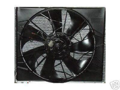

Any of the Lincoln MKVIII fans will work fine, as long as they are truly Lincoln fans and not the Taurus fans, which look similar but blade shape is different.** Some Lincoln fans are rumored to be 2 speed fans but...I have two of these and both are single speed.. The one on my car is a 1993 with probably a couple hundred thousand miles on it by now, still going strong.* You will need a 50 amp relay to run the fan, 8 ga wiring and a good alternator.* I run a factory style CS-144 (140 amp) and it runs everything in my car fine and holds 13.8v @ idle with full electric load, full heat soak, in the middle of summer.
Here is my fan install thread with pics of the fan, wiring, alternator.
https://www.corvetteforum.com/forums...n-install.html

The Lincoln fans are not reproduced, so you won't find them on Rock Auto.* You can find the replacement motors for them new but..... The fan itself, you'll have to find locally or on Ebay.** There is usually always 4-5 for sale on ebay all the time.* However shipping to your country may make it difficult.
Here is what the Lincoln fan looks like.* There are many others that are close in resemblance but, pay attention to the blade shape and make sure they look like this.
There is a couple on ebay right now for around $140 usd.
