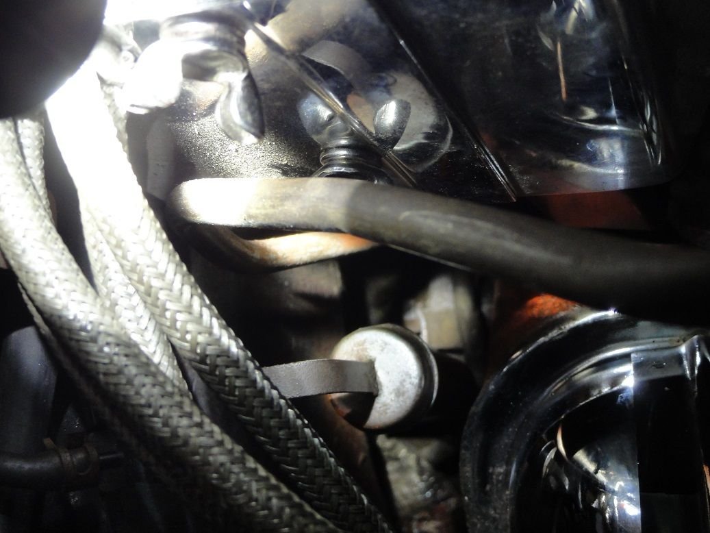

pull the vacuum hose off the modulator,,is it wet with trans fluid?
you couldn't take a few pics top and bottom of the metal vacuum line could you?,i need the routing for my 69 427,and where the bracket that holds it to the trans [which hole is it in too]
Sure Dmaxx
I only see one bracket of any sort on mine. It's a small thing crimped onto the line down where the bell-housing meets the block. It is held on by one of the trans to engine bolts. Then at the top and bottom it is just held on with the hose couplers. I couldn't get a focused pic of that bracket.

That would do it. That line actually goes to the modulator...not the governor.

THANKS,i think mine got run over by a mack truck
