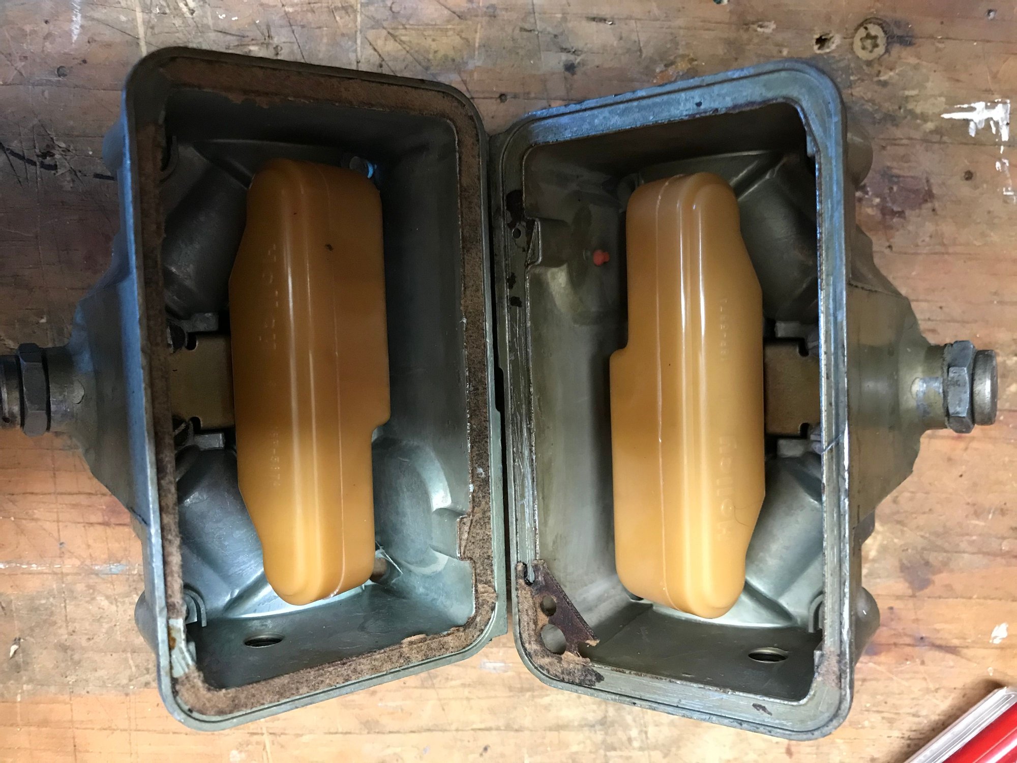

I am just a weekender but I can tell you what I did to fix a nasty dieseling problem. I have an L46 350/350 that a PO put a Holley 4160 (3310-4) on. It had been sitting a long time. I followed the Holley docs to setup and connected the vacuum advance to the ported source. Car ran fine but would occasionally diesel. I found that if I kept the idle low at or just below 700 and waited just a second or two to shut it off it probably wouldn't - but that annoyed the crap out of me. In the course of screwing around with it I switched over to manifold vacuum. I know - I know - hot topic here - but it corrected the dieseling instantly. Is it possible the mechanic just plugged the hose back in the wrong spot and then changed it when you came back again? I am not familiar with q-jets but Google tells me they have both ported and manifold vacuum sources.
As for your Holley. Easy rebuild. Seems like the needle/seats are a bit of a p.i.t.a. and there was an ancient recall that I was unaware of and tripped over regarding the floats but it was a good project. Easy to adjust and work on if you're just leaning, which I am. Nothing like a gasoline fountain in the driveway to focus your attention.......
Good luck
Good luck
Can you give me some info on that Holley recall issue? Thanks.
I probably phrased 'recall' incorrectly. I rebuilt it very carefully and had a bad flooding problem - that's what the gas fountain in the driveway was about. I spent some time on the phone with Holley tech support and there was a very helpful young man that was willing to look at a few pictures I sent him. The old yellowish looking floats were the problem and he was surprised because - according to him - they had been discontinued for years because of various problems. No spring on them and nowhere to attach one. Maybe I'm one of the last few who failed to get the message (there are still people out there unready for Y2K ....)
I replaced them with new Holley floats (black plastic) that do have that spring. So no, not a 'recall' because I had to buy the damned things. Maybe 'product alert' would have been better. To those who rebuild carbs all the time this is probably old news and simple stuff but to me it was well earned experience.
These are the old crappy floats. No, even with those notches you see nowhere to land that little spring.
