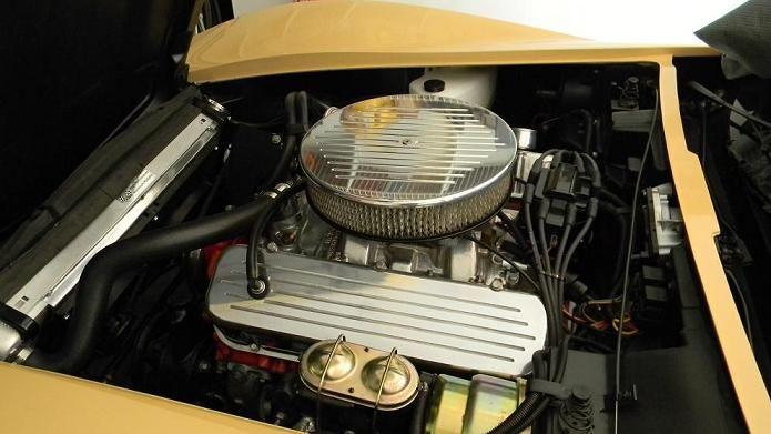

Originally Posted by BigBlock77
John, it looks like you've got a different brake booster there with your tall valve covers. What is the maximum OD on the booster? I stuffed a tall deck big block in mine and don't really want to cut my vintage Cal Custom valve cover on the drivers side if I don't have to. I may end up going hydraboost in the end anyway, but I'm trying to weigh all my options. Mine is also a 77, but I have an 80-82 front clip and hood clearance is a big issue. I need the L88 hood but don't want to spend the $$$ until I absolutely have to. Kids in college get the $$$ first.
It's 7" wide. I put it there hoping to save a little weight, as I needed a new one anyway. Works fine.
For hood clearance I was able to close my stock hood by using a choke-less Holley carb, combined with a drop base air cleaner and a flat cap.
