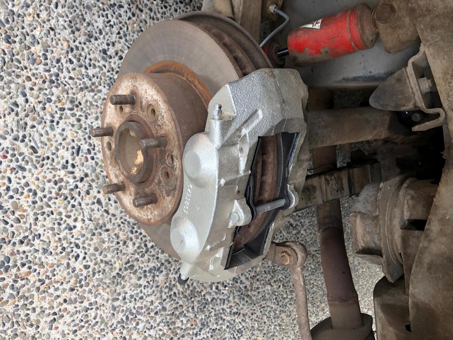

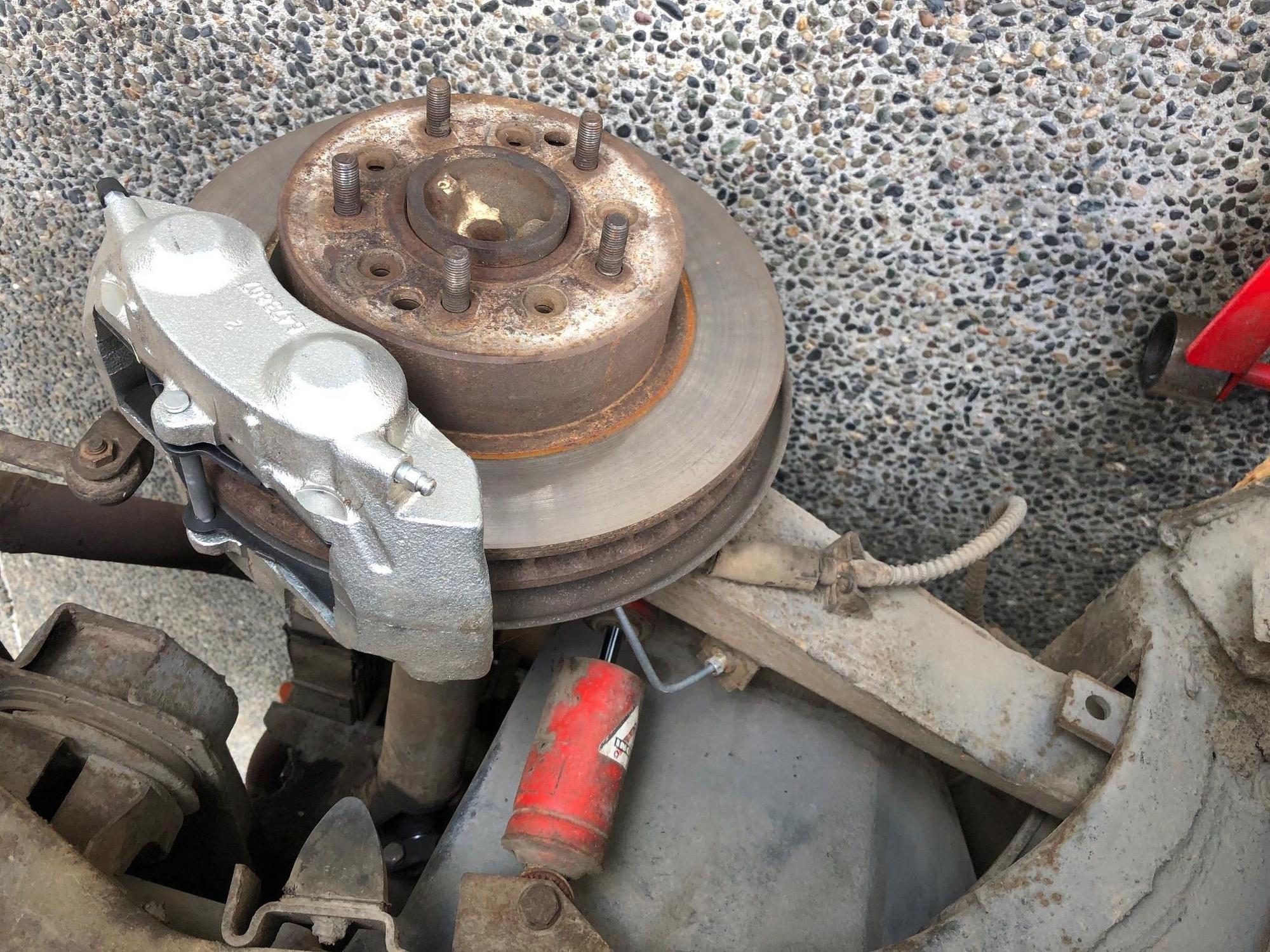

I have LT III 18 X 9.5" Wheels with 1 1/8" Caliper clearance & 4.75" BS This clears all the factory Rear suspension parts without modification. This is what it looks like with 275 40R 18" tires in the rear.
Can you send me measurements from the wheel flare to the top & bottom of the rim, and what wheel specs you currently have. Width, Dia , Backspace. I would like to see how this measures in 3D. But if your flares are 2" beyond the factory flare you would need a wheel with 11.75" Width and a 4.75" Backspace to look similar to my picture.

Lets work backwards and get a better picture of what you need. Measure your current wheels. provide current width and Backspace. Then measure the distance the wheel is from the flares top and bottom of the wheel. We can then get a reasonable requirement.
I don't think 10" wheel will look correct on the back of the car. Also you need to make sure once the wheels are mounted that you get the correct caliper clearance. This will be influenced by the spoke design of the wheel. You need a minimum of 1" from the mounting surface of the rotor.

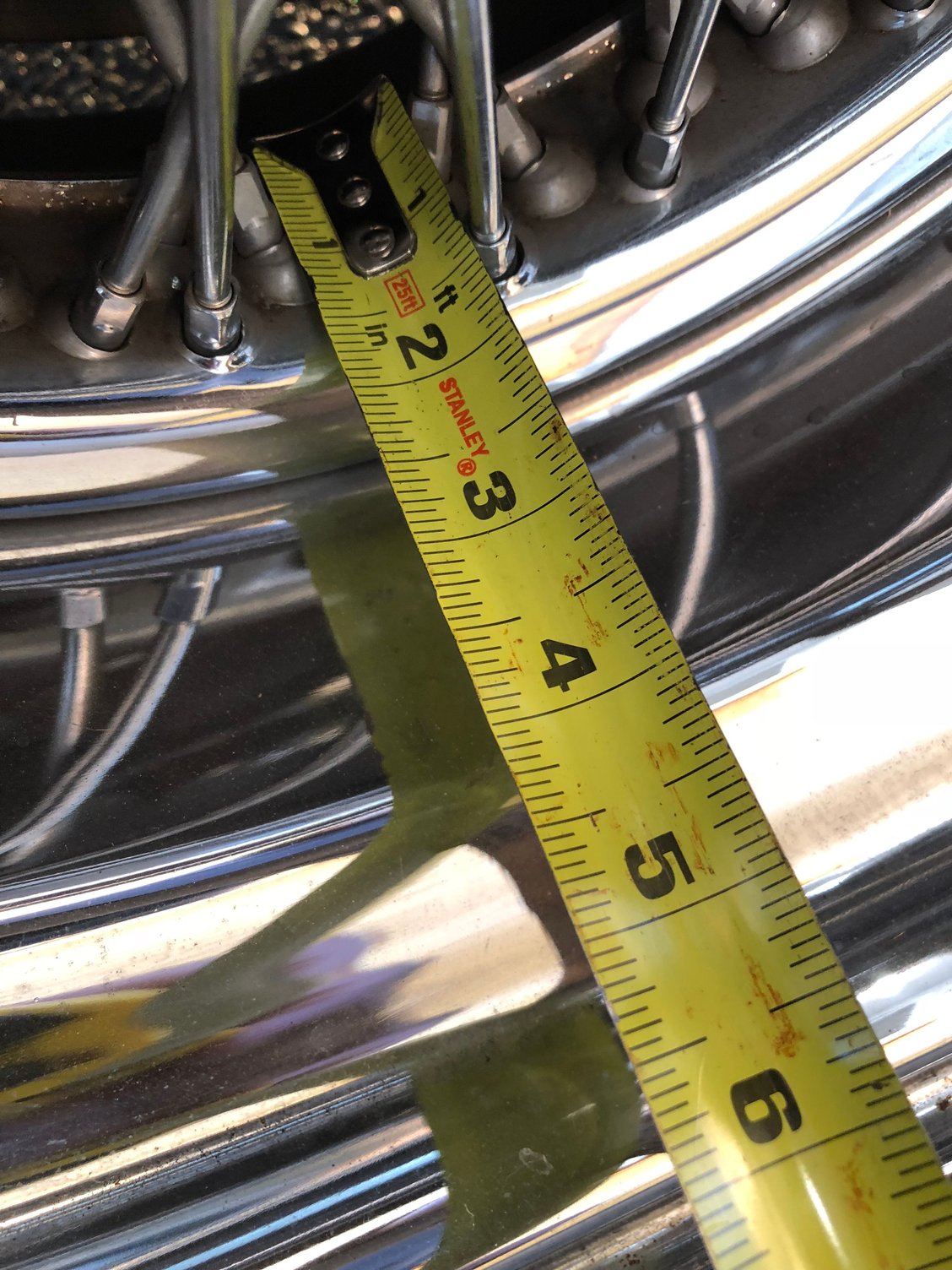

Here are the measurements.
Let me know if I need to do anything additional or make any corrections to the measurements.
Thanks!!

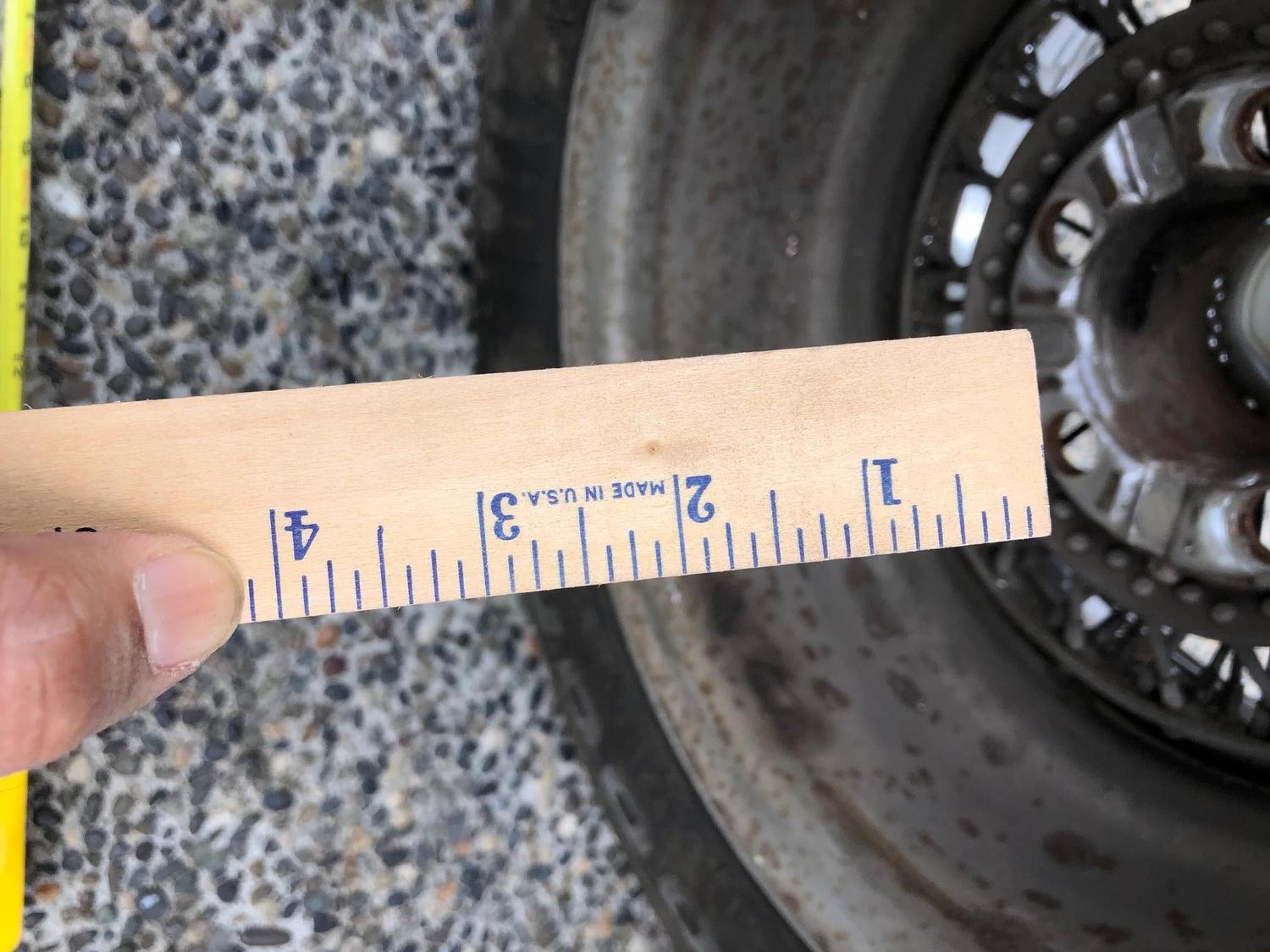

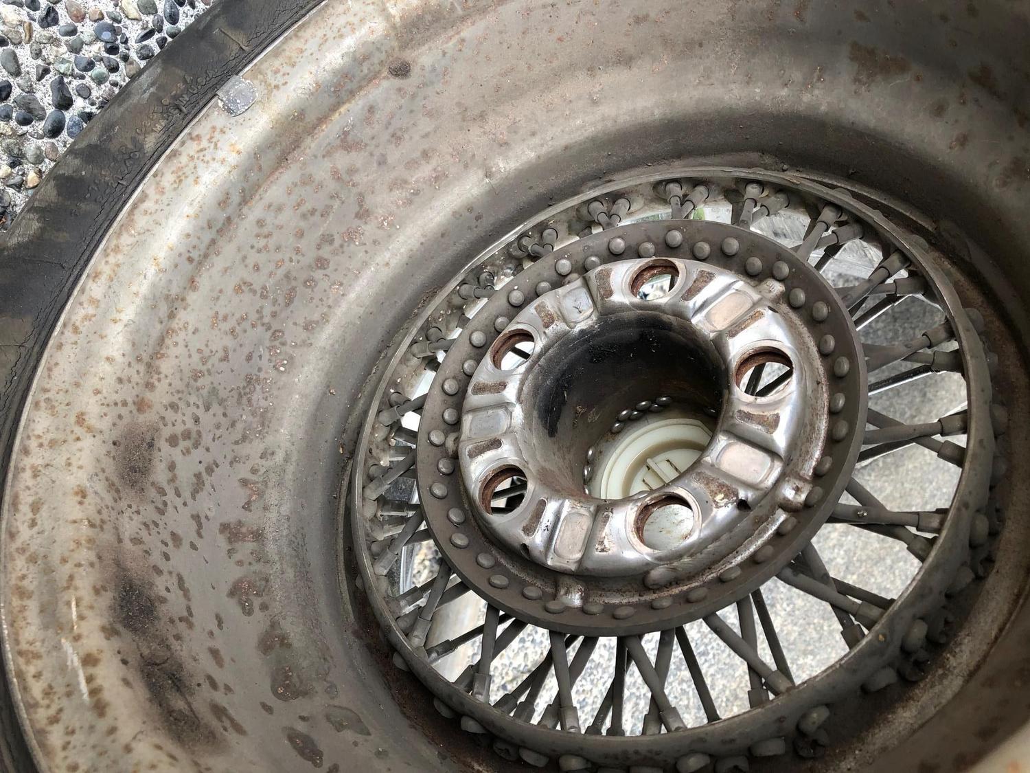

Here are the measurements according to the youtube video. Looks to be just over 4" BS with a .25" spacer. The tire appears to be dry rotted, is that even safe to drive on?
