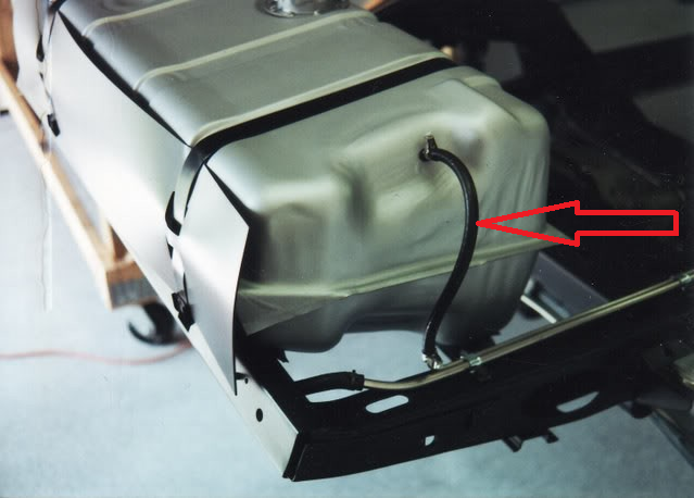

Doesn't the return line end at the top of the tank? Doesn't that represent a problem because of the fuel splashing when returning in the tank?

The return at the top isn't a problem. The lack of anti-slosh plates in the factory tank is. Whenever the fuel level is low it sucks air in tight turns. I lived with it for a while and then spent the $$$ on a custom tank with slosh plates and in-tank pump.

In the 77-81 fuel tank the return line goes to the sending unit at the top of the tank. I think those pics are from an earlier tank.

Found this setup! Good thinking!
https://www.corvetteforum.com/forums...post1591586870
I have a 71 so that would work for me!
