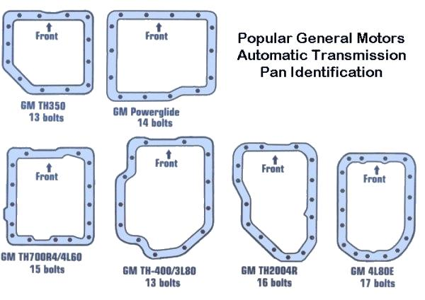

I have to change the transmission filter, but I'm not sure which one will fit... I'm a bit confused case the only numbers I found on the transmission was
B6P19N 16S405468 CFD1 338999 CB1 and to be honest, it doesn't tell me anything... a lot of the filters on ebay look familiar, but I'm really not sure that they will fit ideally...

As a pretty reliable part number source, you could go to Summit Racing and punch in your data: yr & TH350 or 400. There you should see several options on filters and more importantly, part numbers. (plus gasket)

Hi and welcome.
Take a look at the pan and it will help you figure out what transmission you have.

Peterbuilt has come through again. Great drawings.
