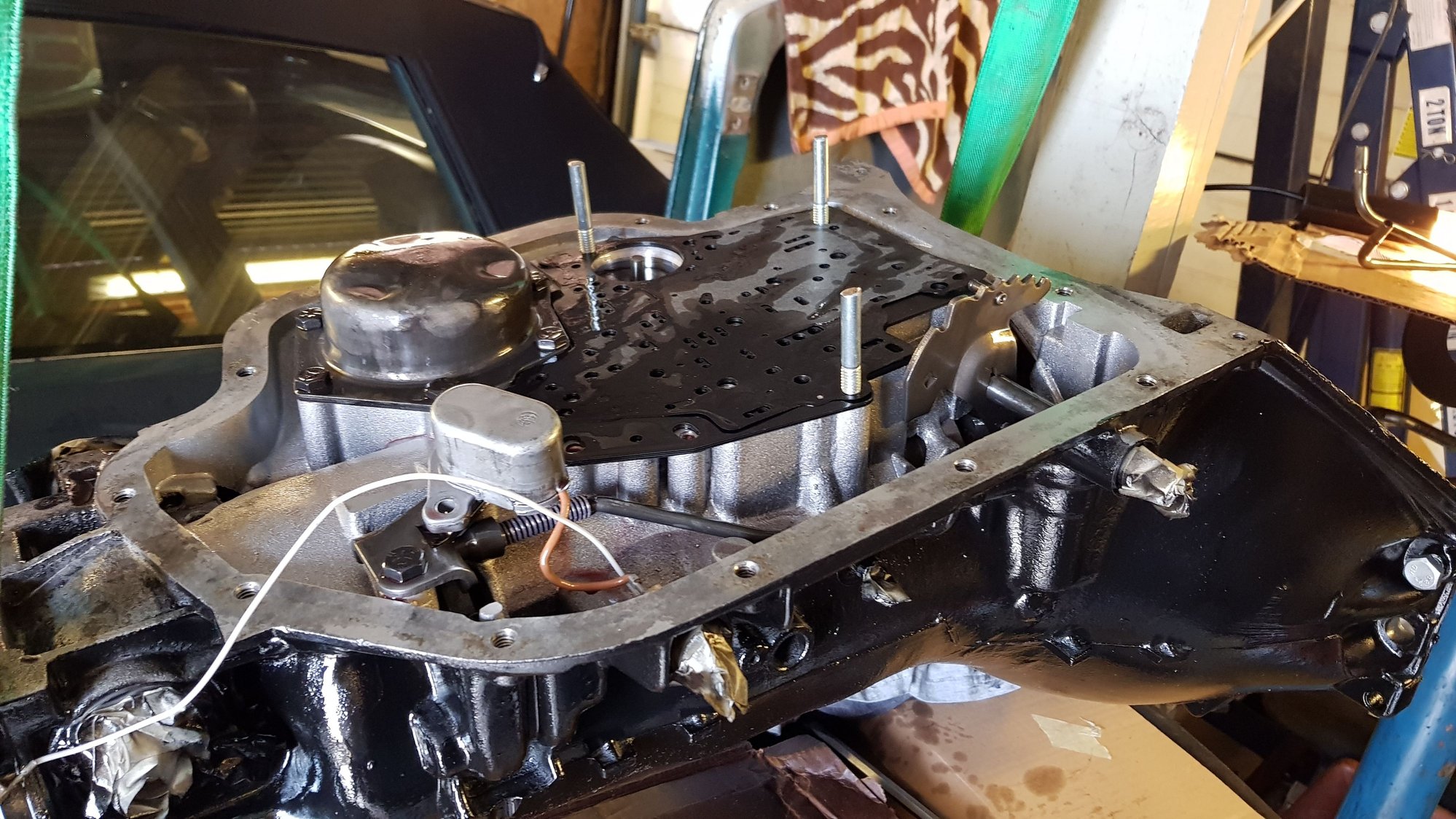

Hi,
Regardless if the engine is in or out, then I would make 3 "studs" as guide for the gaskets and plate. Please see my picture above.
We took the "middel" road, according to the manuel, that means remove 1 ball, and drill a hole, if think it is 2.4mm (please check your self) and the orange spring.
Remember to when you reinstall, then the bolts for valve body, the small bolts are 13nm and the big boltes are 17nm (please confirm yourself)
Also install a olie drain plug in the pan, they cost nothing, and it makes it nicer if you have to go in and change your springs later.
Thx,
John
