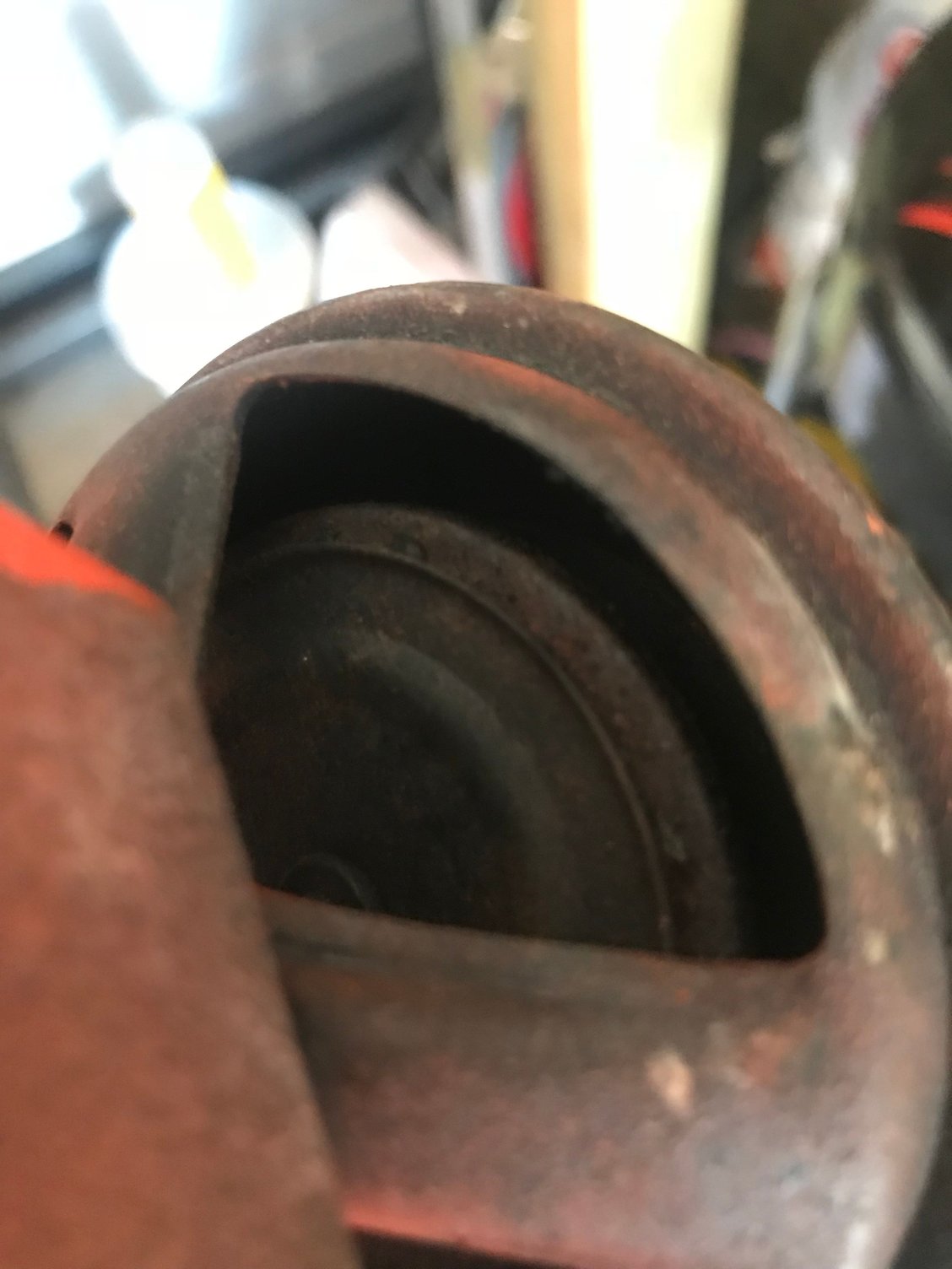

Lol ... pulled off the EGR valve and found out it was completely disentigrated inside.... wasn’t working anyways...

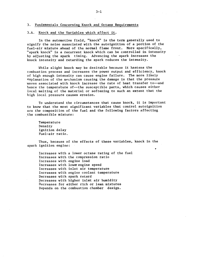

Originally Posted by cardo0
... And the recirculated gas cools the combustion which should make for lower engine temps during low RPM cruise. But not if your cruise RPM is to high...
You are correct, in that EGR will affect combustion temps. Often, spark knock can be more prevalent when EGR is removed. Note attached image from a 1975 CRC report.
Vic
