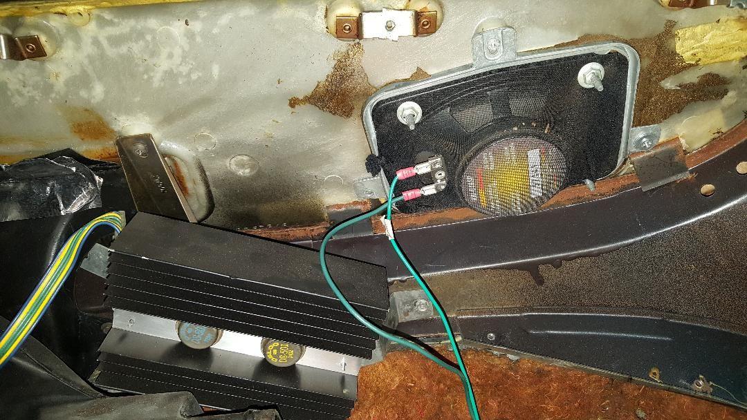

Originally Posted by J Mo
Will 6 x 9 speakers fit under dash without major modifications to mount them ????
No, if it could even be done it would be a major mod. The speaker placement(s) are specifically designed for 4x6's. The area of placement is not flat except where the speakers go. And it's pretty tight up there, especially on the drivers side....All I could find is a picture of my passenger side..

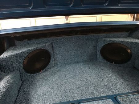

From: England AR
go get 4x6 plate speakers to use, 6x9s sound horrible due the issue of unbalanced standing waves from the extra 3" diff of width vs height... best thing for this is a 4x6 plate, put two rear pod speakers in the rear cargo area and run 6.5" subs in them, your ears will thank you.
This is similar to what im doing, get the pre-built ones, de-carpet them, put a blank board over the front, cut them for a 6.5" sub and re-carpet so they match your existing carpet.
There is plenty of air space for 6.5" subs with their required airspace, and the latest generation of mini subs are pretty hefty contenders, yeah you wont win a SPL competition with them, but they will deff sound great!

Hi @naramlee
I know this is an older thread, but I'm looking at the same rear speaker cabinets.
Did you drill them into the car with the L-brackets? I really like the look of these (especially with matching carpet, nicely done!), but I want it to be completely reversible.
