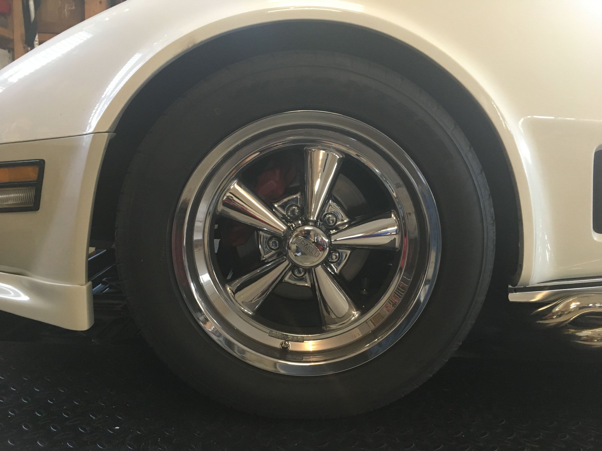

The largest tires to fill the wheelwells without issues are 255/60/15.......These may rub on sharp turns in a '69, so most people use a 70 series tire of the same diameter on the front. Cragars of 7" or 8" widths for Corvettes are 4.25" backspacing which fit nicely. If using stock calipers, you must use 1/2" spacers. (I have Wilwood narrow calipers on mine, so no spacers are needed.) I have 15x7's on my '69.........they actually measure 7 1/2" wide.......Cragar's measurements are generous. They now have a Vintage line that is a chrome plated aluminum version of the SS's if you want to save weight. I have these......https://www.summitracing.com/parts/c...3442/overview/ If you need spacers, this is the kit........https://www.summitracing.com/parts/crr-29200
Pic.......

Yes, the chrome plated aluminum looks as good as the chrome steel.......you can't tell the difference......you're seeing the chrome plating, not what's underneath it. The pic is of the chrome plated aluminum. I went to Summit to look at them before I bought them. (I'm lucky enough to live close to Summit here in Ohio). They are even more impressive than the steel SS's in my opinion. Though more expensive, I believe they will last longer because they won't rust out like the steel ones eventually do.

I ran the steel Cragar SS on my 79 for years - then about 3 years ago went to the aluminum version that C3 Stroker mentions (a 17" version). He is right, they look great. I pretty much went through the same process, except with Jegs (I live about 20 minutes from their warehouse). You cant go wrong with these wheels - I get a lot of compliments from people at cruise-ins and car shows on the aluminum Cragars.
The close-up is the new 17" wheel - it does need cleaned in this picture:
